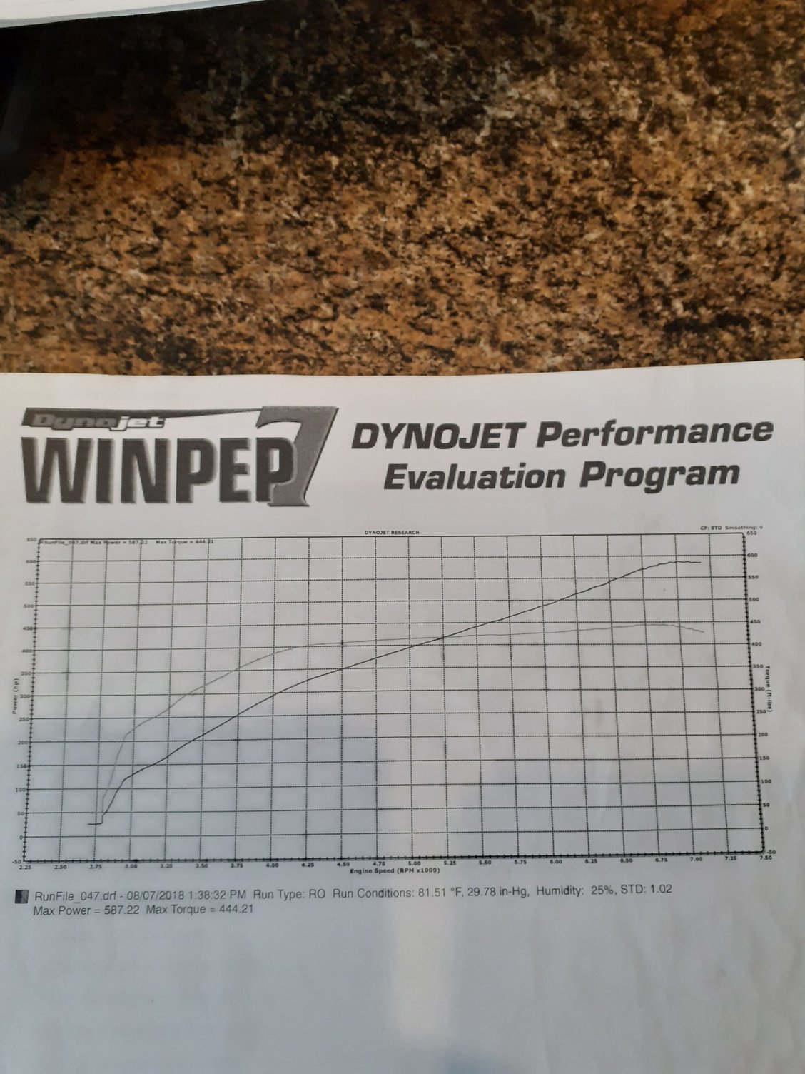

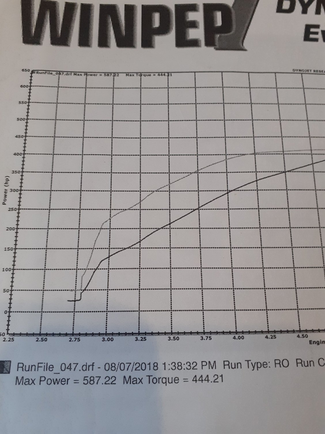

But a short list is a AAM built stage 2 block, sleeved with forged internals. Heads done with +1MM valves, Kinetics intake, everything ported. Gready twin turbo kit with G18 turbos, true SS dual exhaust. Modded fuel rail with 1000cc injectors, E85 sensor, twin 255 fuel pumps with surge tank. ECU is a LINK +4 Extreme . Im sure I missed some stuff..
Found my last dyno sheet from 2 years ago before the E85 work.
