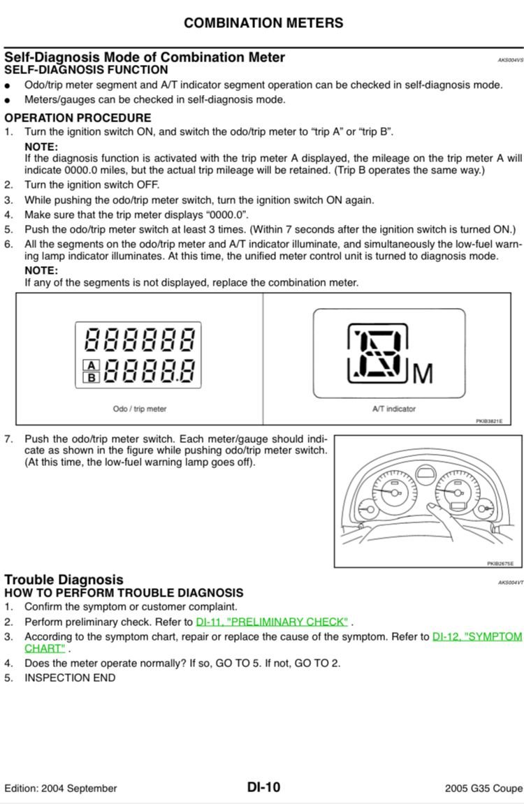

You can put your cluster gauge into test mode. That should make everything light up and your needles move to a certain point. If your fuel gauge still doesnt move then the problem is with your instrument cluster.
Heres how to do it:
