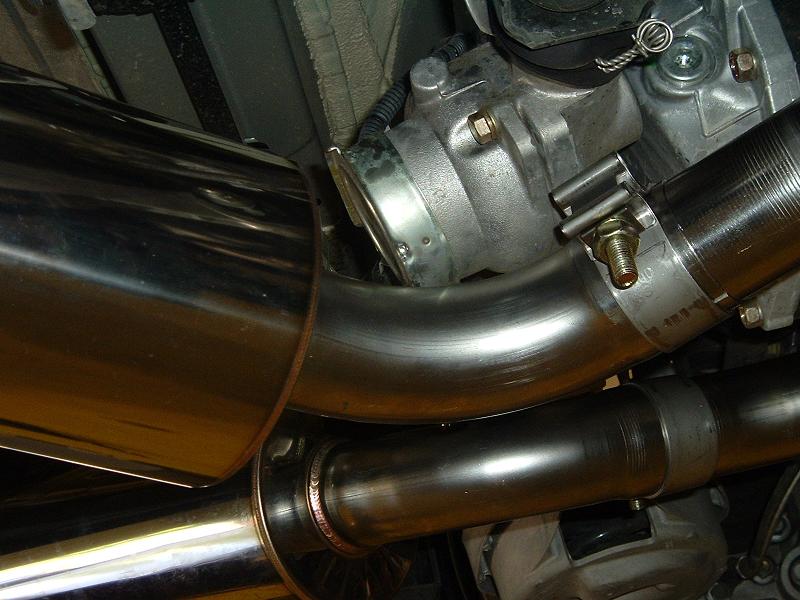

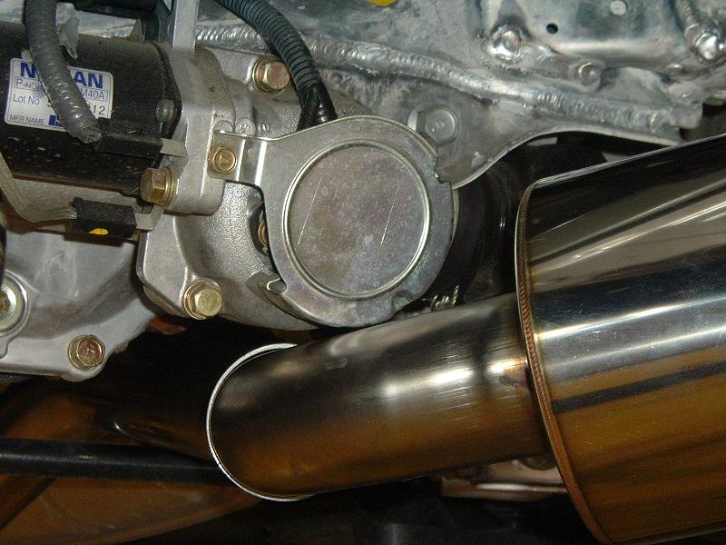

^^^You are correct.
It fits but your right side pipe is slammed into you RAS servo. Then if you lower the pipe to clear, it rests ontop of your rear sway bar.
After market exhaust with RAS-injen-ras-servo-01.jpg After market exhaust with RAS-injen-ras-servo-02.jpg
Currently have that section wrapped with fiberglass racing heat shield tape.
Doesn't rattle anymore either. Temp fix untill I have a work around fabricated.
Hear the HKS hi-power dual has problems w/RAS too.
