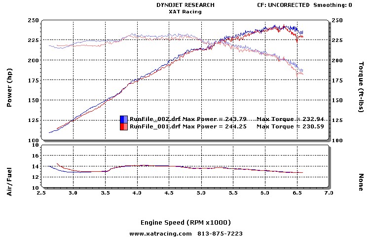

I have DC sports stainless steel headers which is what the alphaworks and topspeed/pro-1 headers clone from.
I also have the following:
Crawford cast plenum
Crawford high flow cats
Borla true dual exhaust
K&N Typhoon intake
Back in the day when I had nothing, my base dyno was 230HP, 222TRQ. Here is my most recent dynojet graph taken during hot Florida weather
Attached Thumbnails N/A - headers a yes or no?-ian-b.jpg
