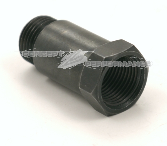

You can buy them pre-made from ConceptZ Performance: http://www.conceptzperformance.com/C...370.246.42.239, GruppeS or on eBay. They'll cost you about $20 a pair and they're simple to install (at the rear or the muffler end of the test pipes). See picture below.
