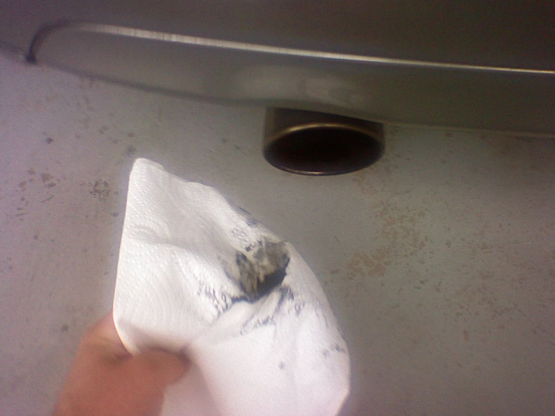

Originally Posted by ISMSOLUTIONS
Just another note:
These cars put out a lot of blowby for FI especially.
Case in point...
On the bright side, paying $500 for new HFCs will probably be the least of your problems if you go FI.
