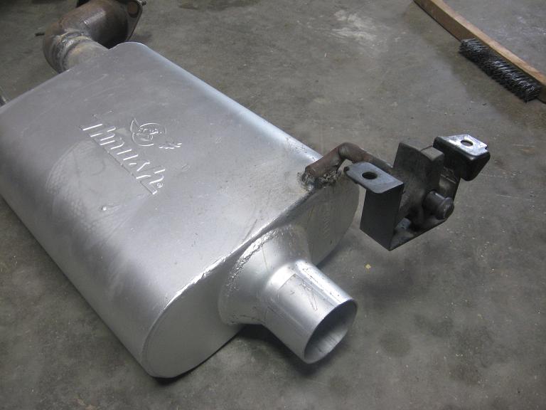

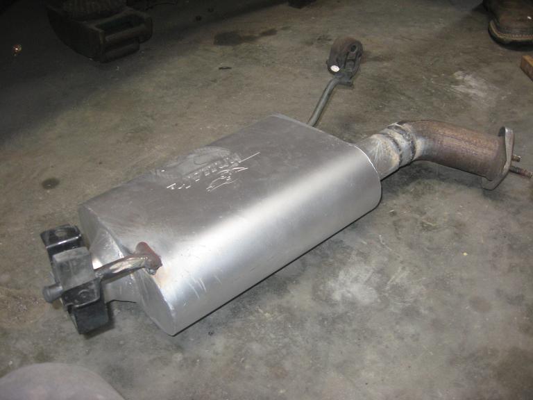

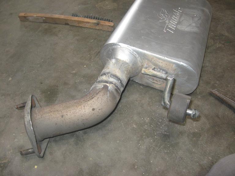

I bought a "thrush" muffler 2.25 dia. Its an exact copy of a 40 series flowmaster. Flows patent ran out so they moved in to copy!! Hey they're only $30 from summit racing.
First I unbolted the stock muff and cut the tube and flange from the back. then bolted the flange and tube back on and positioned the muffler where I wanted it, then tacked it in place. Then welded it up. Next was the stock hangers which I cut off the original muff positioned them on the new muff and tacked and fitted then welded it on. Then welded the tip hanger on and now I only have one tip.
I really didn't want a loud raspy sound neither did my wife (its her car) so I figured this would be a cheap do up. Its not a huge difference but its a little more "throaty" and a little deeper sound.
What do ya think?
Stock:
Thrush:

Not bad. It is a little deeper. I wonder if a coupe middy would have just been the trick for you though. But for $30, its cheaper alternative (minus the work you put into it).
Put some vids up of it under load (drive bys is possible).
Very handy work

Wow man, nice job for $30+labor! Not too loud but more aggresive for sure.
