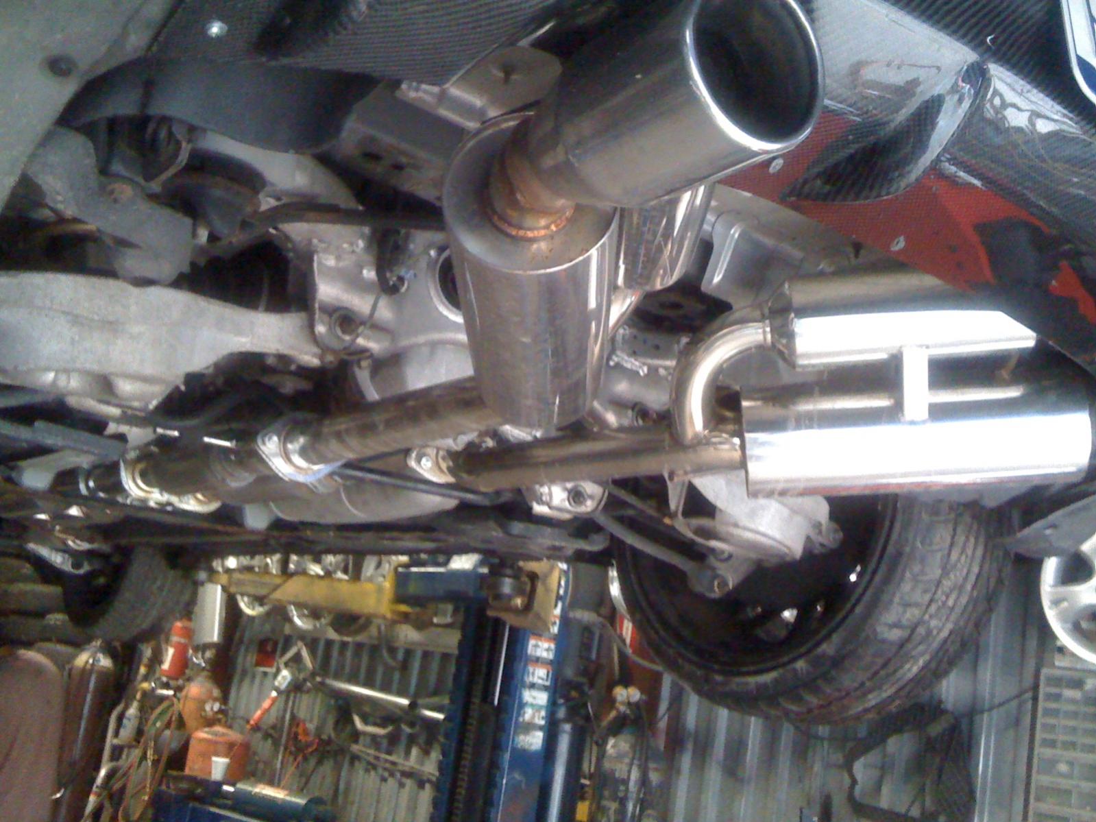

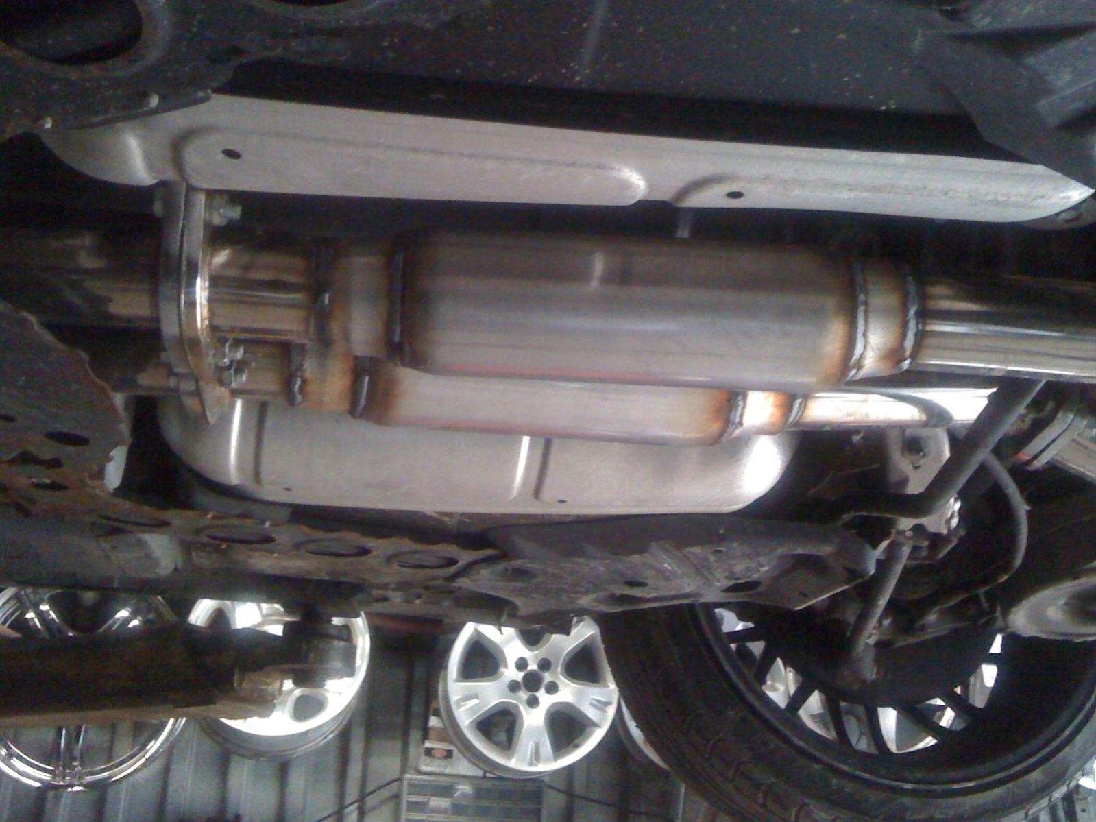

Got the resonators on, and have to say that the sound is now MUCH cleaner. No more of that farting noise when the car is under load. Gonna have to polish them when I have the time, but the upshot is it no longer sounds ricey under load, which is the only thing I really disliked about the exhaust. They are 3 inch resonators with 2.5 inlet and outlet.
I'll try to post a sound clip later this week. Still sounds awesome under WOT, and now sounds mean, but without the drone at the lower revs. About 2X as loud as stock, and now sounds much cleaner. A MUST for anyone who has this exhaust, in my opinion. Hard to find polished resonators though......

Nice Carbon Fiber Rear end Tom's Z

Thanks man, Nismo replica
