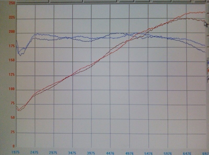

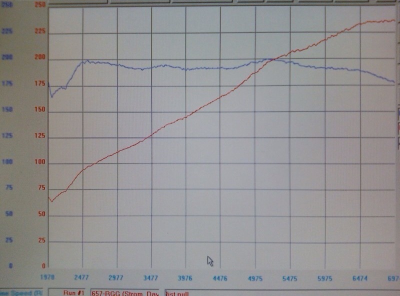

Stock dyno. We both thought the Torque was off though.
Car never left dyno during install. I wanted good repeatable numbers. The temp went down 3 degrees between runs, that is all.
Dyno after install:
I was at work during install, car is still strapped to the dyno. Sorry for the poor quality, these are phone camera shots as the operator was and is still very confused with the results.

Old Oct 2, 2009 | 12:41 PM
Hydrazine's Avatar
iTrader: (23)
Joined: Jul 2004
Posts: 3,054
Likes: 85
From: Los Angeles California
I'm not exactly sure what role changing out the spark may have played. If the ECU optimized spark timing to the old plugs and new plugs were installed between the plenum change out, new plugs may have changed the new optimum spark point... before the ECU had time to relearn a new spark map. It would be preferable to not have that as a new variable.
Also, I do recommend unplugging the battery negative as opposed to just unplugging the ECU fuse. Current is constantly flowing through the throttle body. Even when the car is off.
So when you install the Copper Iso Thermal, when its unpluged, other parts of the electrical system may object to it.
Unplugging the fuse may have the same effect as disconnecting the battery negative but I personally have never tried this so I can't confirm the effect up or down.
I do know one thing for sure, the electrical system on this car is highly networked and a lot of it is powered up even if the key is removed.
As for the baseline dyno. How does it compare to other Z's and G's that have been tested on the same dyno?
In any event, I am sure something else is affecting your dyno results. Its much too low.
Old Oct 2, 2009 | 06:10 PM
davesxx01's Avatar
Joined: Sep 2009
Posts: 115
From: Madison, WI
Ok, after hours of playing with this and talking to Tony from Motordyne I've come to the conclusion that my car hates me!
We took the plenium totally off and rechecked everything. Re dynoed it and lost even more power!
One thing that is constant is that while dynoing the slip, abs, and vdc lamp is lit. I have turned it off by the switch but during the run it comes back on??
Is there a secret on keeping it off?
I'm guessing the ecu is cutting back power/throttle as when we go for a test ride the lamps turn off and the car runs great!
I've decided to leave the plenium on for the time being as there are no stored codes and it seems to run good.
Just wish I had dyno proof to back up the claim!
Also, I want to thank Tony @ motordyne for spending so much time on the phone with us trying to figure this out!!!
