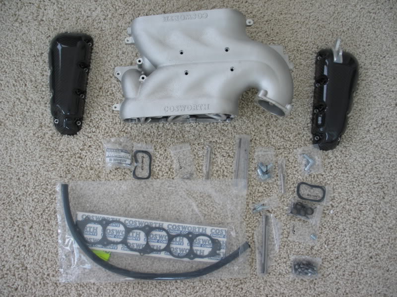

Even though many users have previously posted about the Cosworth Intake Plenum not performing well on non-FI car, no one has really done a good before and after test. So a few months back I took the plunge and shelled out the premium to get one to hopefully gain some power over my Motordyne 5/16th and MREV2.
As expected from cosworth and any premium items, Build quality, packaging, and looks were top notch.

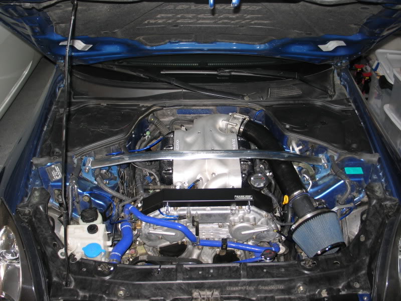

Installation of the unit was straight forward, other than three things.
1. My box didn't come with a manual so I had to get one faxed from the vendor.
2. Installing the gasket for the carbon cap is really a pain in the butt and would appear to be very susceptible to leaks.
3. The bracket on the passenger side carbon cap is not meant to last. It broke off right after I started the engine. Luckily it's not vital for the operation of the plenum.

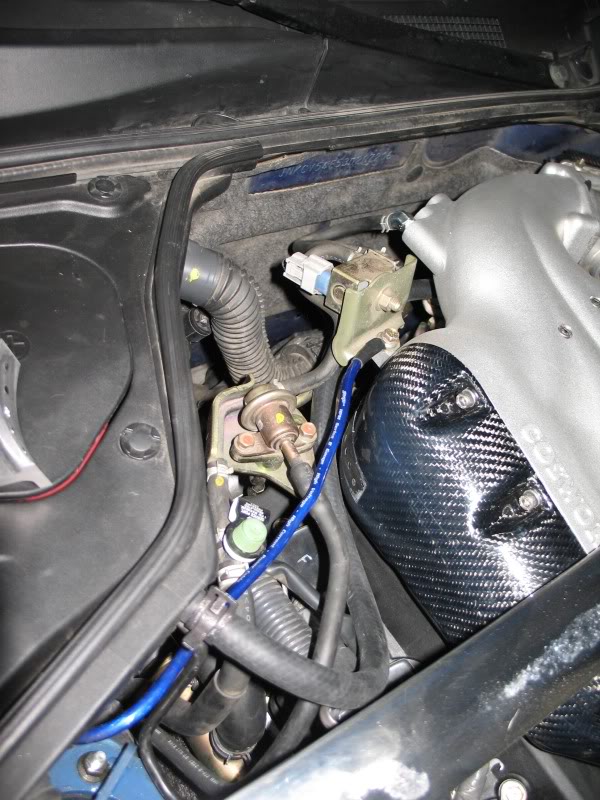

After installation, the manifold definitely looks a lot nicer than the stock setup and clears the strut bar much better. Please ignore the dirty engine bay.

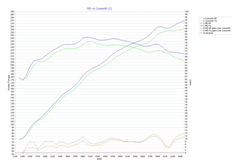

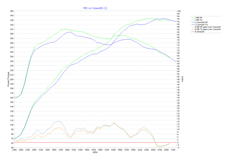

Aesthetics aside, how did it perform? Driving the car around a noticeable power loss can be felt down in the lower and mid range. I was quite disappointed to say the least but I never trust my butt dyno so off to the dyno it went. Below is a series of two different test comparing the Cosworth on a fully NA engine.
Based on these tests, it is apparent that the Cosworth is not suited at all for my application so back to the Motordyne setup it is. But I must say that the one performance advantage the Cosworth has over the MD is the ability to sustain power pass 6500rpm... to be continued.

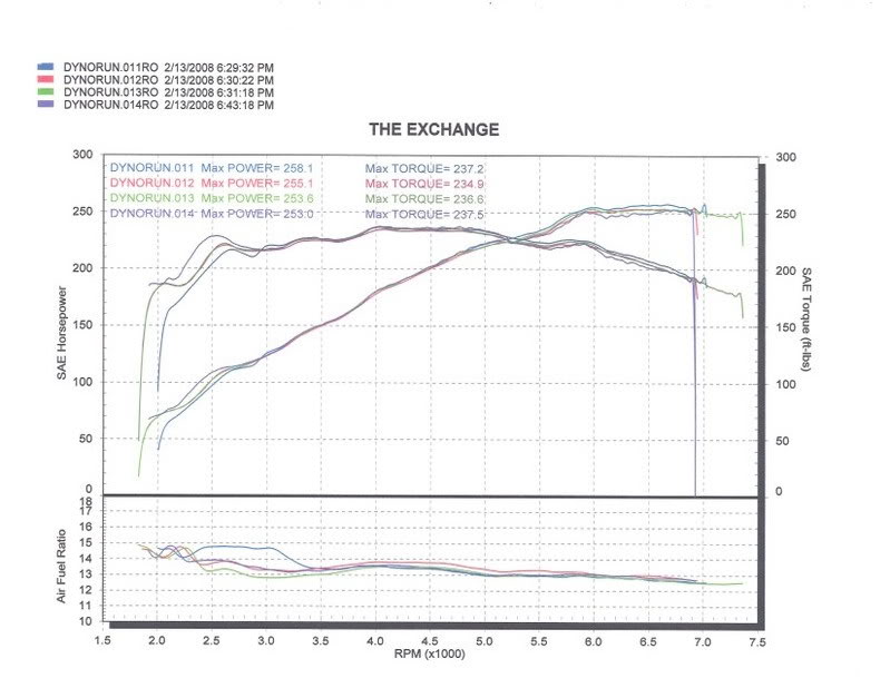

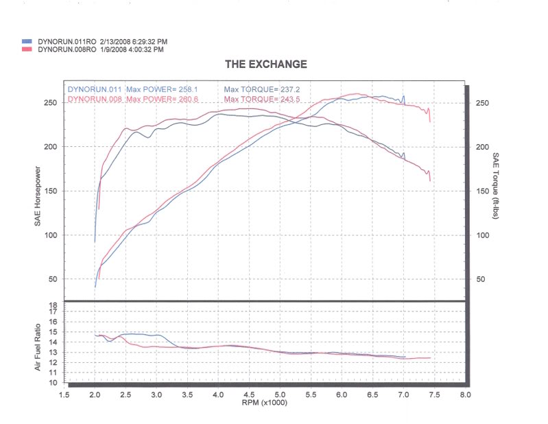

did you not see my dyno comparison from 02/08?
https://g35driver.com/forums/2687535-post31.html
https://g35driver.com/forums/intake-...ed-pics-3.html
[QUOTE=jonnylaw;2687535]Name:  dyno_Page_1.jpg
Red: MD 5/16 iso spacer, MREV2
Blue: Cosworth Plenum
Breathing mods: Arc intake, Amuse titan tube, nismo headers, PE HFC's, Tanabe y pipe, Amuse Titan exhaust, UR pulleys, Technosquare reflash
All the pulls made today with the cosworth plenum:

^ Good thing you posted in here Jonny, I figured you would since you were one of the early adopter of the plenum and it's good to get some more data points on this interesting product.
I've seen your test, but the unsettling area in your test was the tune and the time difference between the tests which didn't sit well with me so I did a series of three tests on my own. One which is not shown here since it was on the engine dyno and comparing it to something different.

Understood. I was trying to do another back to back test, this time while F/I. But my tuner is tied up for a couple months, so I'm deciding to just put back on the new Cosworth plenum I just got. Maybe later on, I will do a back to back comparison of the 5/16 spacer/Mrev2 vs Cosworth on my HKS SC setup.
Thx for taking the time to do these tests. It's clear the MD 5/16 spacer/MREV2outperforms the Cosworth on a N/A revup. Gains of the Cosworth on a typical N/A setup are similar to a spacer alone.
Of course we all know, the Cosworth shines on high boost/high rev applications.

Definitely looks like Cosworth for NA is neither the best nor the best bang for the buck. Both those titles go to Motordyne. Thanks for sharing.
