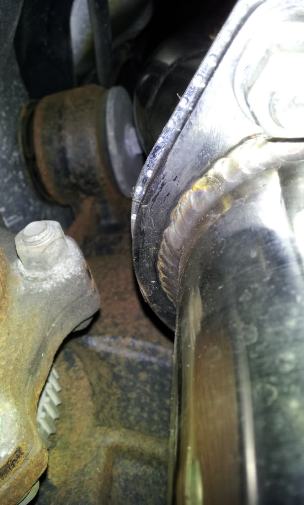

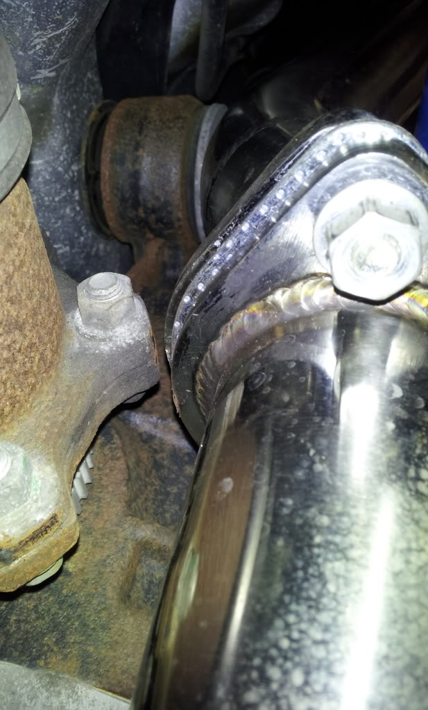

Also, I have MD sway bars, On my passenger side muffler where it connects to the straight pipe that goes over the sway bar, I had issues of it touching that. If i moved it, I had issues with it touching some gasket on the pumpkin (see picture)

Before:
After:
I had the same problem here. But my exhaust was stuck right on there... so ZERO clearance at all.
After hours of F-ing around trying stuff ended up doing this:
Finally got it to clear a bit
ARK i hope your reading this.

Well the flange still hits on that drive shaft as im driving. fukkkkkk.
Going to have to take it to a shop
EDIT: Gave ARK a call and they are working to remedy the problem, good on them. I will keep this updated on what their solution is.
EDIT 2: still no reply from ARK, and I honestly dont expect one back - lol
Took my car to a shop. Took them over an hour of bolting and unbolting trying to align it perfectly. They did it! It clears now, but only slightly.I havent had any problems so far. Cost me about $120 to get it aligned. So my total cost is about $1620 for this ARK. $400 more I couda got the Motordyne
