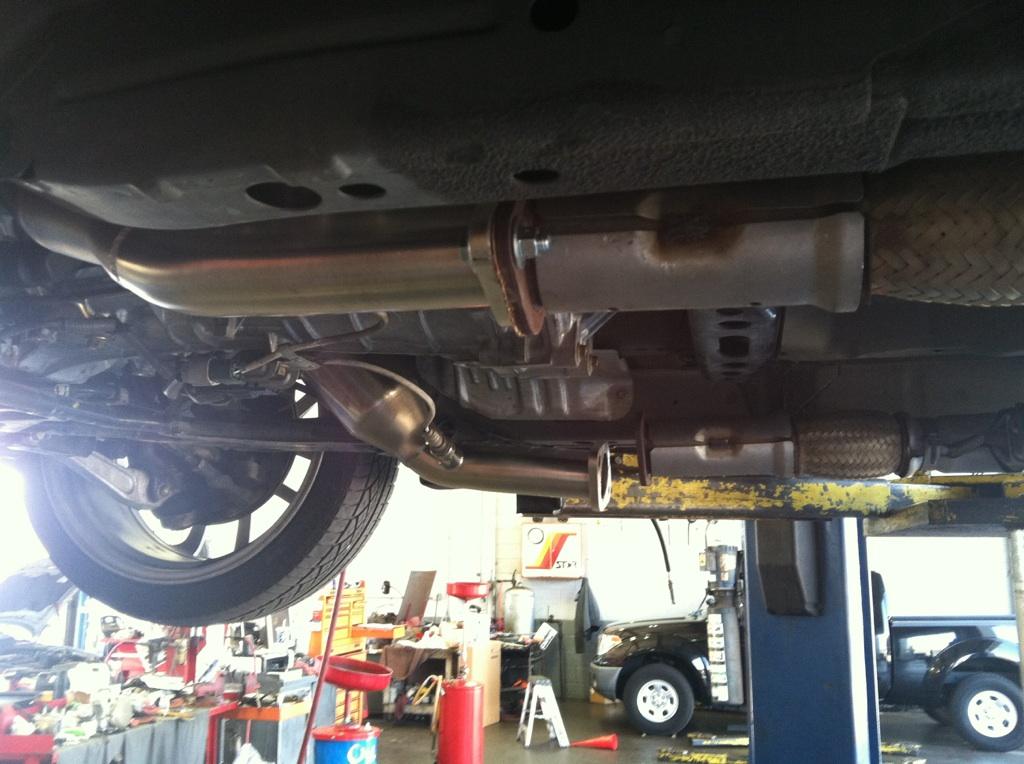

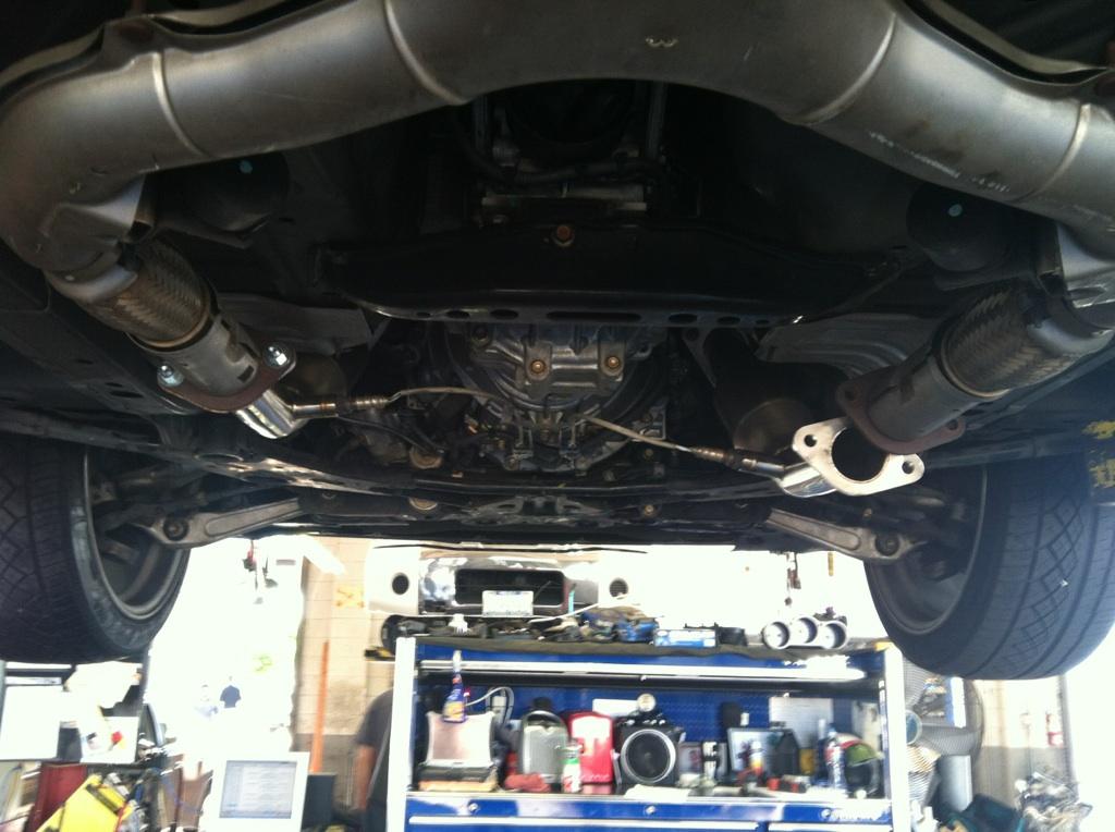

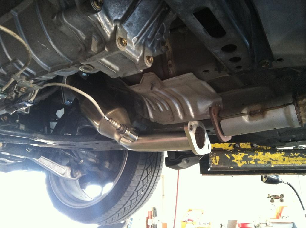

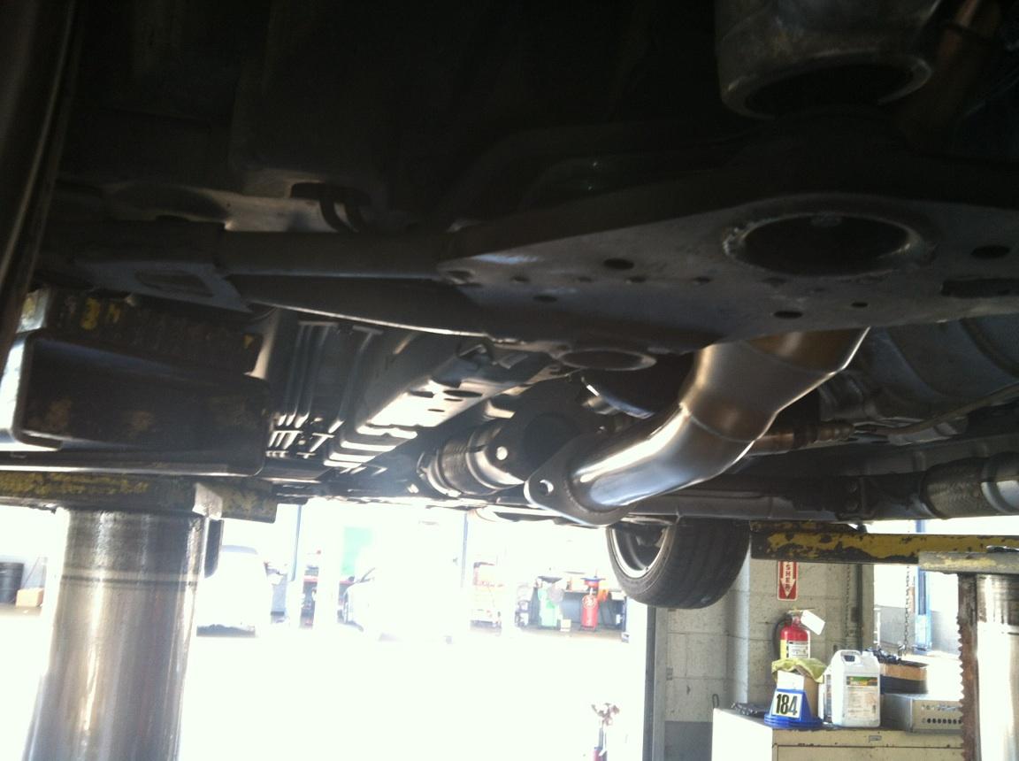

I just had HR manifolds from a 370z installed on my 06 coupe. From what I read this was a direct swap, aside from the mounting studs being moved inward. I purchased kinetix HR HFC to pair with these but the fitment is waaaaaaay off. Where did I go wrong? Are all HR manifolds the same? Should I have got them from a 350z instead? I thought it was a defective cat but kinetix said they use a jig, making it unlikely.
Attached Thumbnails Help with HR exhaust manifolds on DE-img951017.jpg   Help with HR exhaust manifolds on DE-img951018.jpg   Help with HR exhaust manifolds on DE-img951016.jpg   Help with HR exhaust manifolds on DE-img951015.jpg

Get those extension pipes coming with the exhausts on Ebay, cut them, measure them, weld them back and you should be good.
You should have been modding with parts that fits your model, would save you a lot of headaches.

It's fairly common. Im just not sure why my set-up isnt working.
