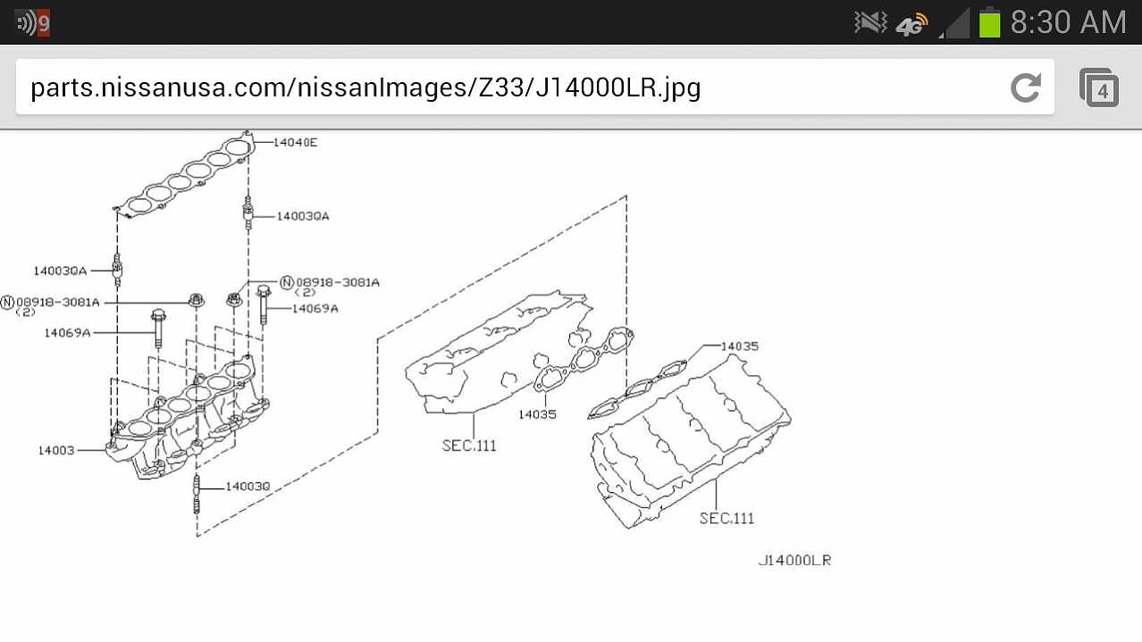

According to the Nissan website they are the same part number, part numbers can be seen in attached images. In addition, motordyne offers one as well:
http://www.thenismoshop.com/MOTORDYN...5DE_p_435.html
I did my research. It seems like this may even be better than a Plenum spacer because if a thermal manifold spacer is used it will cut down on heat closer to the source. I'd love to hear from anyone that has this, otherwise maybe I'll give it a shot and write a review when I get some disposable cash. (Poor college kid status ftl)

Runner length has nothing to do with why a plenum spacer is installed, at least on a G35/350Z. That theory might apply to other models so limit my response to the VQ35DE found in a G35/350Z. The reason for the spacer is due to the design of the upper plenum. In order to clear the hood on the early 350Z the upper plenum slopes down to the front of the engine. Because the upper plenum is very close to the opening of the lower intake runners, the front two cylinders actually get starved of air. The plenum spacer fixes this "design flaw" and provides better airflow to the front cylinders.
The VQ35DE "Rev-Up" engine has a different lower plenum design and doesn't suffer air starvation that regular (or non-revup) engines have. The rev-up plenum has its own flaws, mainly due to shorter runners and thus loss of torque, but has better flow near the rev-up's higher redline.
The intake spacers in your first post apply to FWD VQ35 engines that have a different intake design that doesn't apply to the RWD engines. (Apples and Oranges)
The manifold spacer from motordyne is really just to provide clearance for aftermarket injectors. In theory the rev-up engine might see some gains from the runner lengthening, but simply swapping on a non-revup lower plenum yield such good gains that a measly 1/4" spacer seems like a waste of time.

^ correct. The lower intake manifold spacers are used to allow clearance for taller injectors - that is all. You will theoretically increase midrange torque at the expense of peak power, but it'd be minimal. I have one spare if you need one that I will let go cheap
