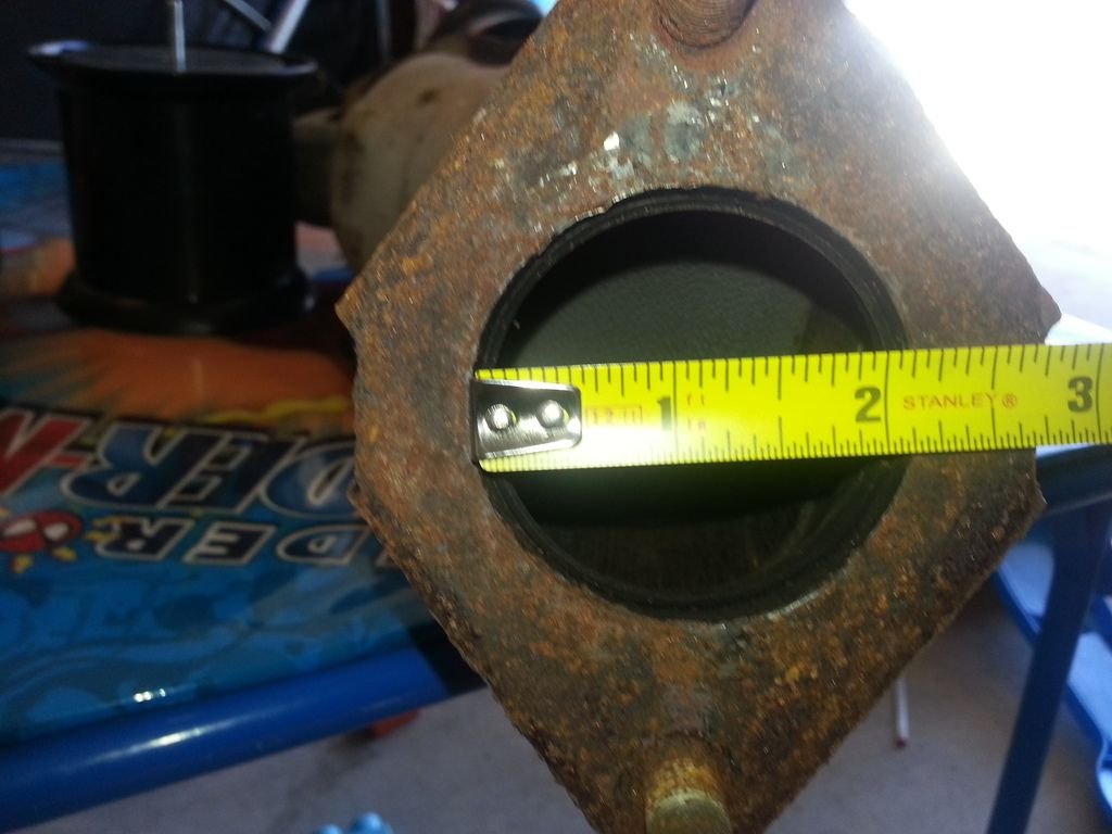

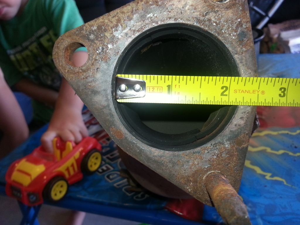

I managed to track this down, so I will post it here for others.
HR stock cat inlet diameter = 2 1/4” I.D. @ flange face
HR stock cat outlet diameter = 2 1/4” I.D. @ flange face

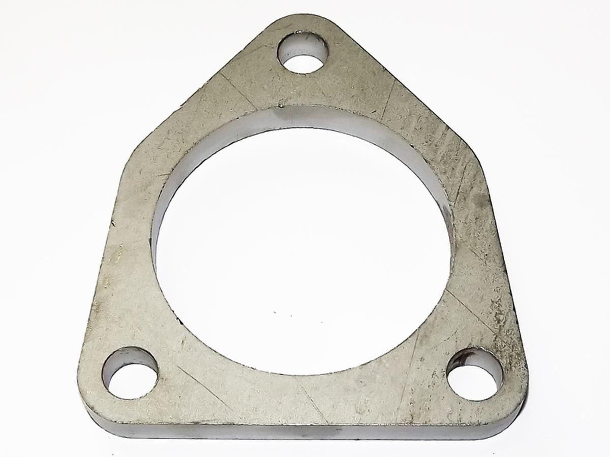

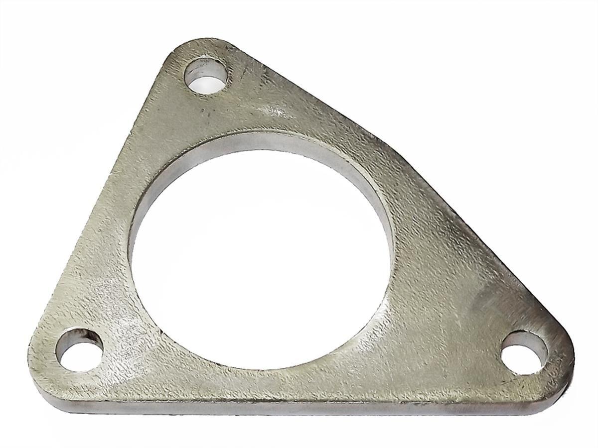

The flange at the inlet is the same 3-bolt design, but the bolts are at a different spacing.
VQ35DE
VQ35HR

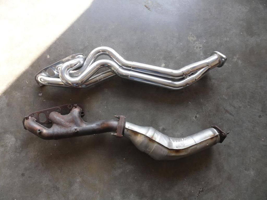

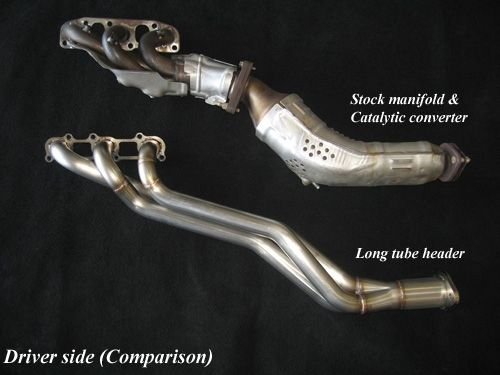

Comparison of DE vs HR factory manifold and cat connected
HR
DE
