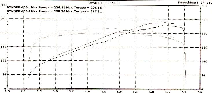

so i put my copper mrev plus on sunday morn. I had it dynoed again, i also had a baseline 1 week ago. I have a 06 6mt with sports package ( 19inch wheels) with a z-tube and popcharger i pulled 227 hp and 201 tq. It was 85 degrees out. I had it dynoed again yesterday, with the m-rev and it was 105 degrees out. so the true results are probably better. I pulled a max of 238 hp and 217 tq. That being said i would tell everyone to get this. The shop i did it at could not belive the change from last week. When i was telling them what I thought it was going to pull (prayed to gain 10 hp and 15 tq.) they thought i was nuts. They were dumbfounded at the end of my runs.
If you are thinking of doing a mrev-plus. DO IT. YOU WILL NOT REGRET IT ONE BIT.
Old Apr 18, 2006 | 09:32 PM
  #27
topherc29's Avatar
Joined: Mar 2006
Posts: 43
From: AZ
you would probably like to see this
