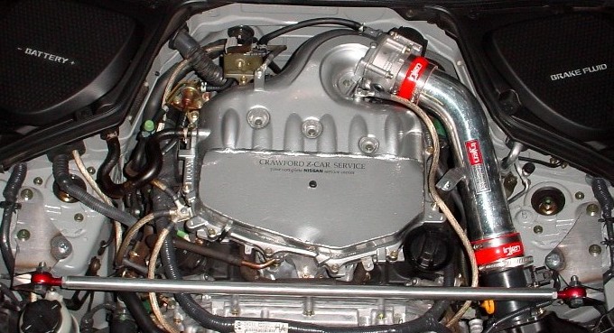

Which one?
Attached Thumbnails Crawford V5 plenum install problem.-crawford-350z.jpg   Crawford V5 plenum install problem.-crawford-v5-decal.jpg

Dave O. The one on the right. Mine powder coated shiny black.
