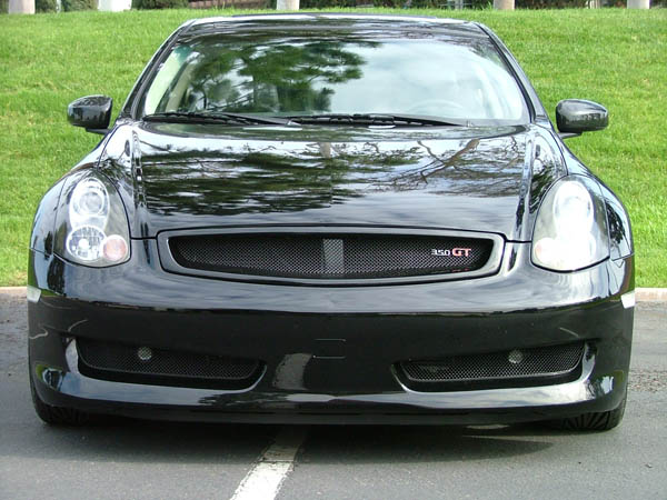

Here's a pic off their website. Looks sharp!

Funny you should mention that. That's exactly what I did. That's my BO coupe in the pic. They hooked me up with enough mesh to do the Gialla grille and the lower two grilles. It required cutting the lower grilles out with a Dremel and using epoxy to mount some securing points for the mesh (just like the mounting method used on the genuine Gialla grille). I'm not sure how the SP grille mesh is mounted.

Thanks. I'm not sure what their mounting hardware consists of. I cut up pieces of ABS plastic (about the size of a Now and Later
) and drilled a small hole through them. Next, I lightly sanded the inner surface of the bumper in the spots where I wanted to mount the harware. I cleaned up with alcohol and used JB Weld Kwik to attach the plastic pieces. I used some wire to secure the mesh to the plastic pieces (8 pieces per lower grille). I got the 1/4" mesh and am very happy with it. Dremelling the stock grilles was a little nerve racking but isn't difficult. Patience is the key.

PS - K6 your G looks slamming with that mesh! We were unsure how to go about mounting the mesh in the stock location, but K6 did a great R&D and has the results to reflect his efforts!
