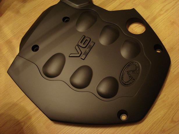

Sand it with 180 grit on a DA. then get a product called bulldog plastic promoter. Shoot the bullgog on now prime em. Let dry wetsand them with 400, clean, paint.
Old Dec 19, 2006 | 12:33 AM
G352NV's Avatar
Never enough
Joined: May 2004
Posts: 4,339
From: Sac town
I just did this part the way I posted above. Its ready to wetsand with 400 then paint.
