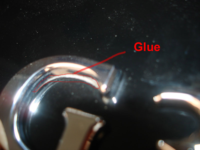

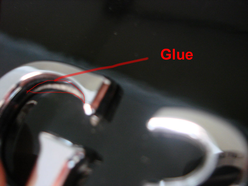

hey guys recived my G 2 weeks ago and i planned to debadge today, i used a hair dryer to warm the glue up and use fishing line to remove them, i was trying it, but i saw alot of tape glue under the words only the G was coming of and the white glue was still on the car, i was thinking not to go futher and stop there and ask on the forums, will the glue come off with goo gone? or will it be permenent? the glue is very thick , i dont wanna mess up my new G coupe. i posted some pics of the promblem.

try to heat it up more and get the line closer to the paint so you can get most of the glue. be careful not to scratch your paint. get some goo gone to remove the rest of the residue.

you don't have to heat it up to remove it. Just twist the letters and it will come off. When you take the letters off then some of the glue will still be on the car. I used regular alcohol and micro fiber towel to remove it. Don't rub the towel all over the trunk and don't do long strokes. Just right on the spot where the glue is. Wrap the towel over the finger or something and gently apply pressure on the glue spot and switch to clean surface of the towel for the next pass so that old glue that is on the towel will not stick to the car again or scratch it.
That is how I did it and It's flawless.
