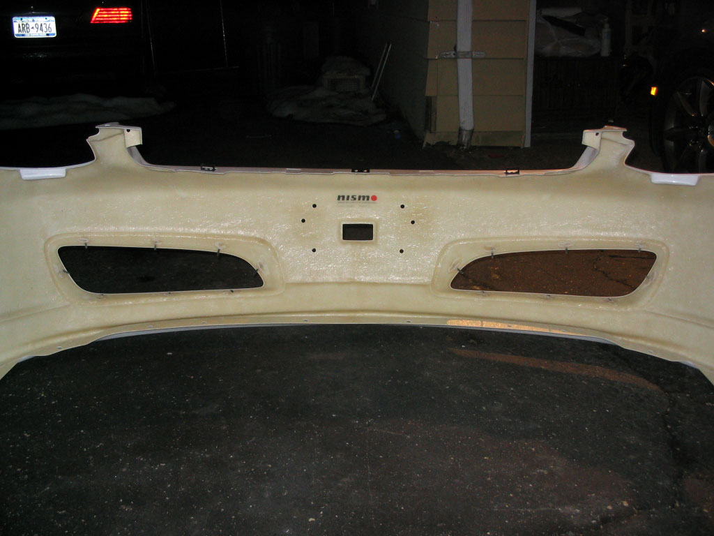

THis is the best I could do while at work. There should be holes along the bottom of the bumper that line up perfectly with the holes on the OEM bumper. You use the same brackets/bolts from the OEM bumper to hold the plastic undertray in place.
the poly nismo fronts that i have dealed with were shorter on the bottom. the plastic undertray would not reach the bottom of the poly nismo bumpers that i've seen and thus zipties/custom extensions were used.
