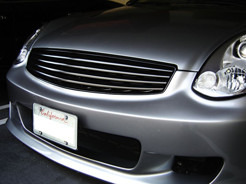

Just finally got mine painted semi gloss... body shop charged $100, had it in a day.

wow!! that's really nice!! i bet that would look good on OB.. how did you go about taking off all the extras on the grill and leaving only the 4 lines? just cut them with some type of dremel???

Thanks! Caskyline was making the grilles without an emblem a few months back, I got it probably close to a year ago - I finally just got around to having it painted. I'm not sure if he's still making em, last I heard he wasn't.
