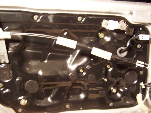

Hi Guys
I'm replacing my faulty window motor and im stuck.
I've already removed the panel but im not sure what to do next.
Im assuming the silver panel needs to be removed but I am unsure which bolts to remove.
The service manual says the window needs to be removed, and to lower/raise the window until you can see the bolts. But since the motor is gone, I cant do that. Is this a necessary step?
What do i do from here?
Thanks guys

ok relax you are in good shape here..
you don't need to remove the window at all to get this sorted.
your next step is to take off the silver panel. you will find that thewindow motor is attached by 3 bolts to the middle of the silver panel but on the other side
so take off the silver panel, replace the window motor, and repalce the silver panel
keep at it!
ps the only reason i know is that i am from australia and my V35 is imported from japan - so i have no warranty and I just replaced this motor myself!

when i switched out my stock doors for CF ones i had the transfer windows and regulators...its pretty self explained...just take out the bad one and put the new one in..the most difficult part was making sure the window itself was where it was to begin with...it just takes some trial and error...dont put the door plate on until your window fits where you want it..or you'll find yourself taking on and off..the 10-15 bolts holing the plate on...GL

Originally Posted by RiCeBrNr
Thanks for the posts guys.
My issue is since the motor doesn't work I can't lower the window to align the bolts with the hole. The manual calls for the removal of this window.
See my post towards the bottom of this thread. To align the holes, you will need to turn on the ignition and hit the switch a little so they line up.

Hey Guys
Thanks for all the replies!
I've successfully swapped the motor, and the reset worked.
