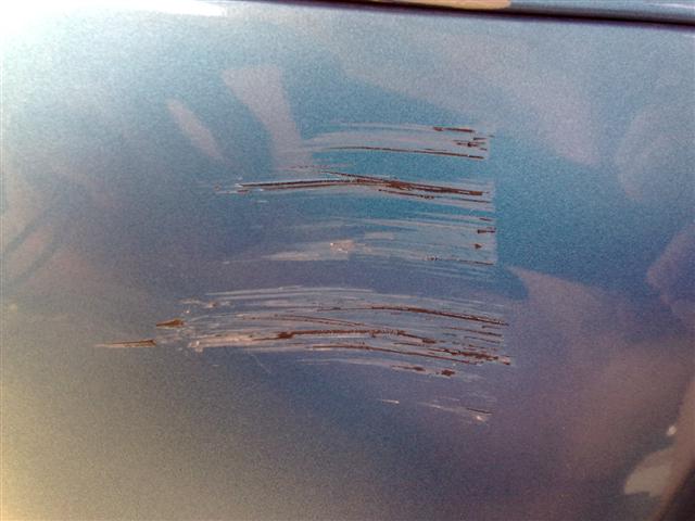

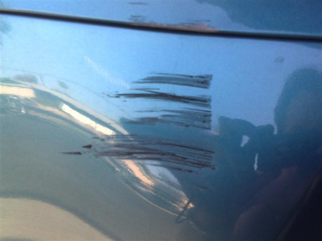

I have a pretty bad scratch on my new G35, The guy I got it from ran the back plastic part of the bumper into his stucco near his garage.
I don't think I want to spend $500+ to get it repainted, I would be satisfied to just make it look less noticeable.
The paint is pretty much gone from the black spots, in the pictures.
I was thinking buffing might make it look better, any suggestions would be appreciated
Thanks
Attached Thumbnails Need scratch advice.-08092009407-small-.jpg   Need scratch advice.-08092009410-small-.jpg
Old Aug 11, 2009 | 03:07 AM
Wrathernaut's Avatar
Gentle Manne of Leisure
Posts: 7,996
Likes: 1,050
From: Pennsylvania
The paint's completely gone where it's black. Buffing isn't going to make it any less black.
Now, getting some touch-up over the black and then wetsanding and buffing will make it less noticeable.
