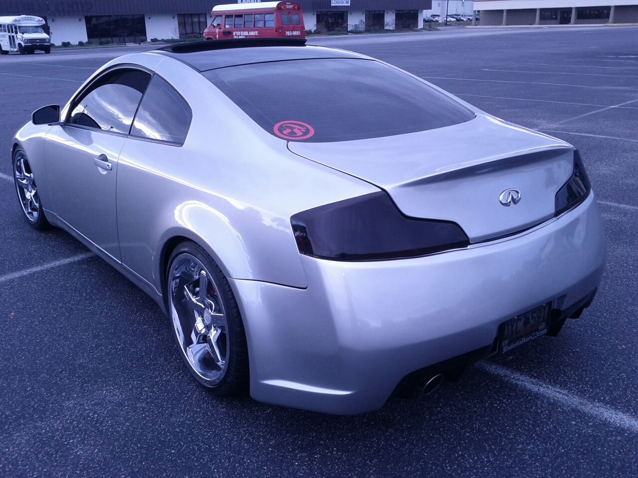

Im having issues with the bumper aligning up correctly with the body of the car. Does anybody know how to fix this issue?
Attached Thumbnails Chargespeed bumper alignment help-335238_977470873621_25004945_42116746_1325719065_o.jpg

actually doesnt look that bad/off. i wouldnt worry about it unless ur super **** lol u plan on doing something with the sides tho? the unevenness must be huge no? take apic!

Ha yea im pretty **** about my car man. I notice the smallest things, Im all about perfection. I cant take a picture right now because Im in Iraq right now. I will get my gf to take a better picture of the stuff im talking about

yeah, that doesn't look good. have the gf take the bumper back to the shop that installed it to try again.

It looks like the bumper is sagging because they didn't put all the bolts in to mount it up.
Just like the front bumper has 2 bolts on each side that bolts up to the front fender, the rear bumper also has 2 bolts that bolt up on each side to the rear quarter panel.
Maybe the shop just got lazy and did 1 on each side since the bolt on the inside is a bit more difficult to access.
