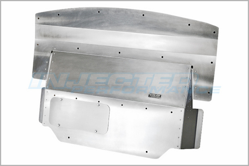

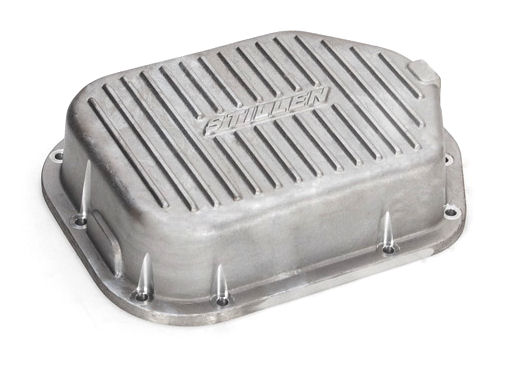

Alright guys. Does anyone know if the Rare JDM aluminum under panel will fit with a Stillen high capacity oil pan?
I've searched and all I could come up with was Tollbooth *****'s aluminum under panel requiring a little persuasion for the Stillen pan.
I called Stillen and they said, they would 'loosely" say that it should work, but no guarantees.
Although, I thought I remember reading somewhere that the Stillen pan puts a bulge in the oem plastic under panel...
I also talked with Rare JDM and they said they have no experience with the Stillen pan, but know it works with APS and Power Enterprise's.
Figured I ask you all. Let me know.

Got the panel in the mail... Just lost out bidding on a ARC oil pan, but have my eyes on the Stillen. Just need to know if it fits or not?

For those wanting to know, I have confirmed with Josh over at Stillen that their oil pan fits inside the confines of the oem under panel with no bulge or clearance issues. Also Rare JDM says their under panel mirrors the oem tray. So no issues!
