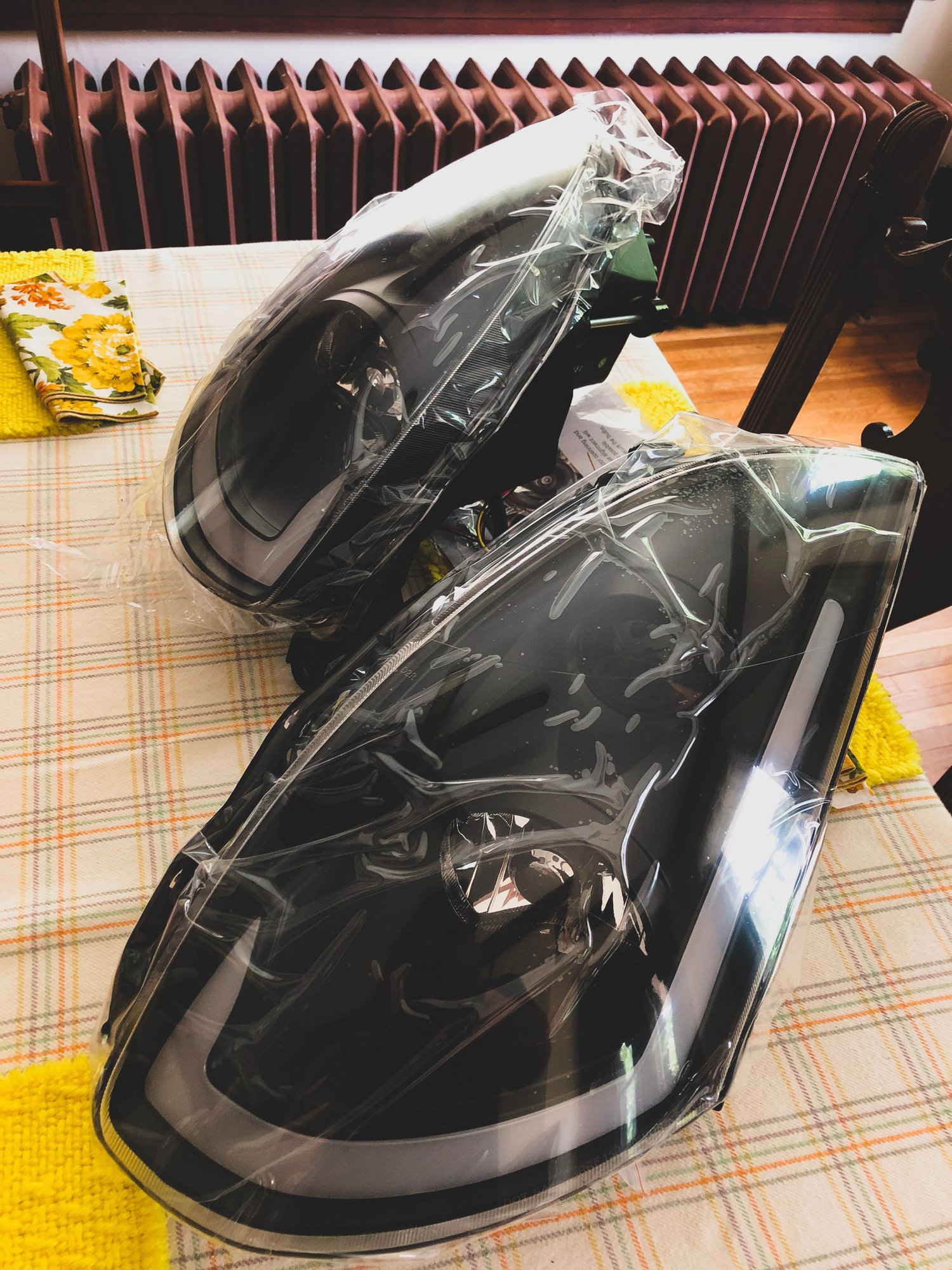

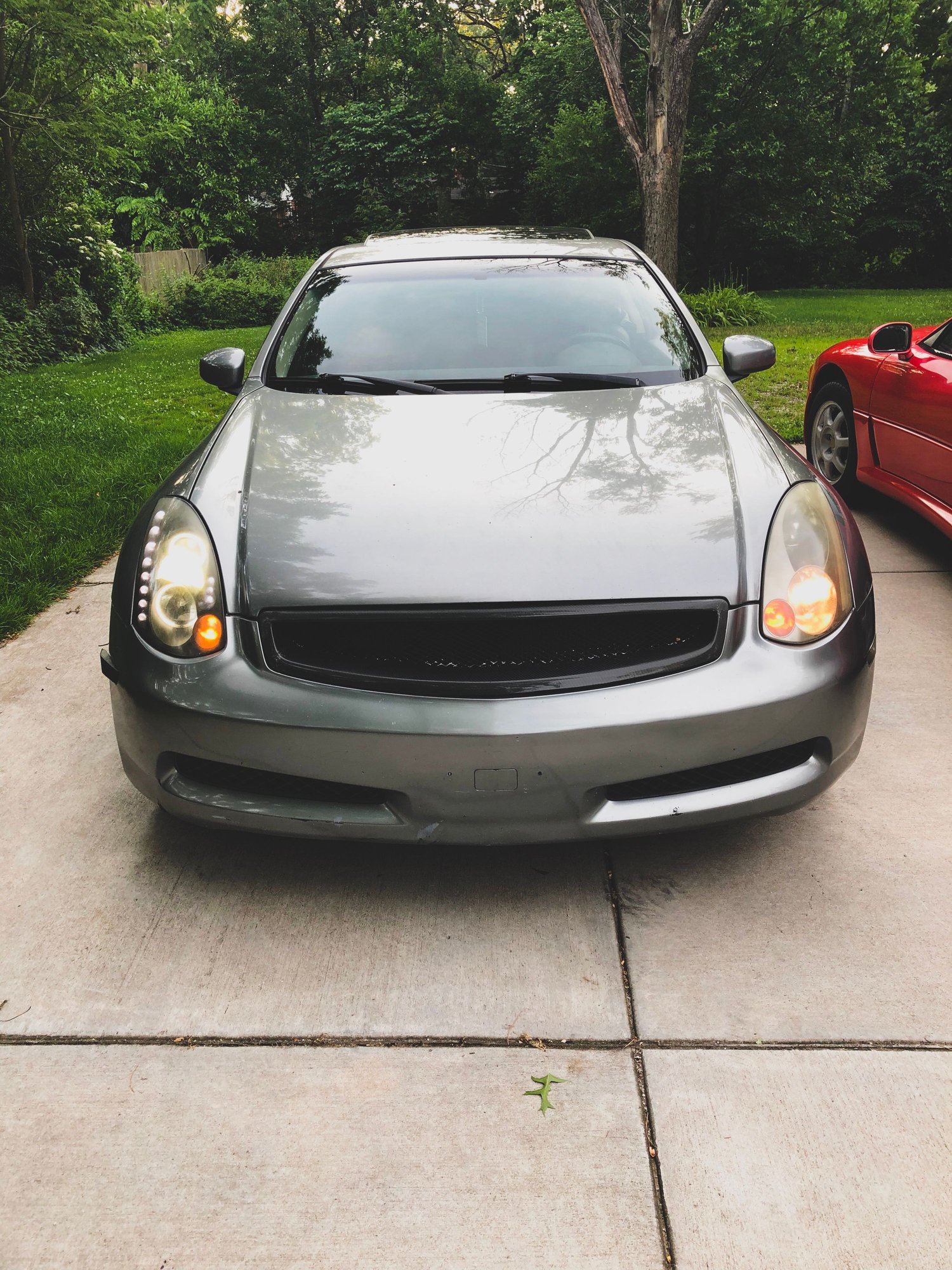

Okay. So I got my G a couple months ago, nbd. It is a 2004 G35c with the Sport Package (I dont know if this is important info or not) It has 2 different headlight assemblies in there, with 2 different bulb colors, and I need to know if I can just pop them out and put in 2 matching assemblies, and it will work fine. Take a peek:
Unmatched headlights
New assemblies - SpecD
The first picture is my G with the headlights turned on. As you can see they are 2 different colors. When I turn the brights on, the driver's side headlight goes completely out, and the passenger side headlight has the bottom bulb turn on (same color as the driver headlight)
I'm wondering if I'm going to run into issues with bulbs not fitting, etc etc. Any ideas anyone? On what might be an issue, etc etc. Thanks in advance.

Swap out the light assemblies with your new ones. U will need to remove the ballasts from the old assemblies and install them onto the new ones as well. Buy 2 new D2S bulbs....color of ur choice. Plug it in and ur done.

Thank you! Was wondering which bulbs ill need to replace if any
