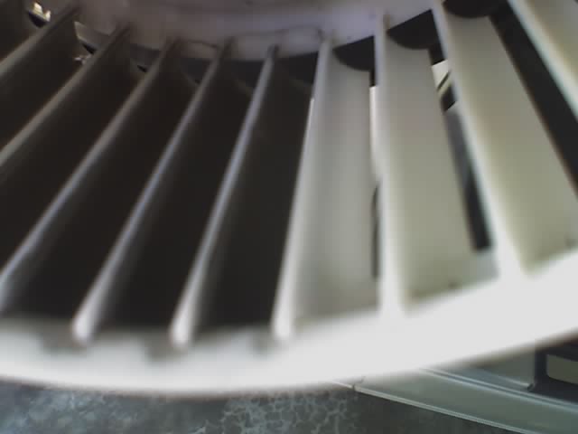

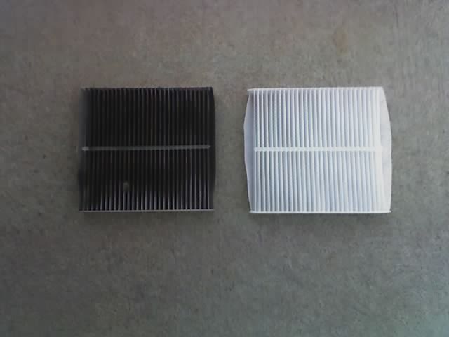

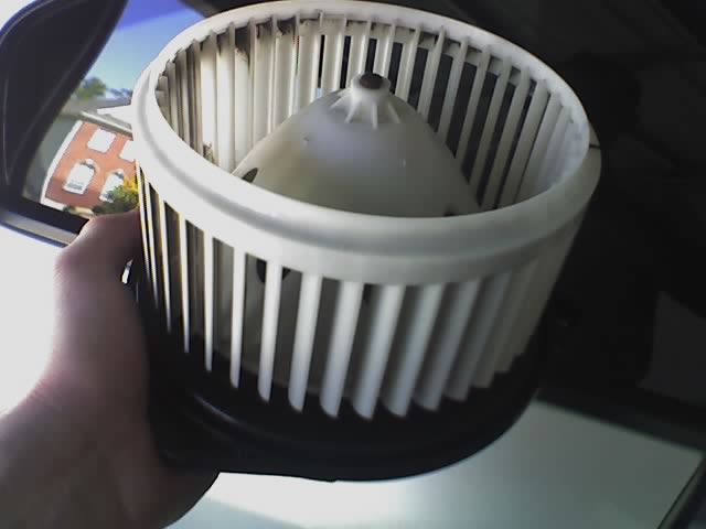

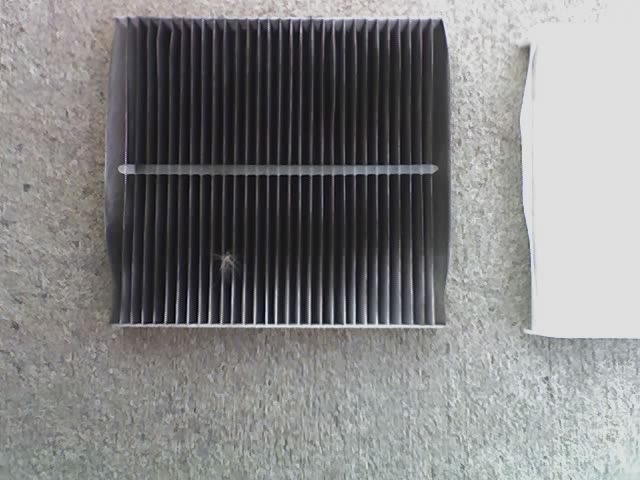

Originally Posted by STL_G
Well I have about 62000 miles on my '04 coupe and I changed the in-cabin air filter for the first time. WOW... was it dirty. I know now that I will be changing this filter often. I never thought it was that important or that it really makes a difference to change it. Look at the pics and see for yourself.
Not only was the filter dirty, but so was the housing and turbine.
Attachment 54588
Dirty filter next to clean filter
Attachment 54590
Attachment 54589
Turbine with soot on left and cleaned section on right
Attachment 54591
How often does everyone change their in-cabin filter?

I think I just unscrewed 4 screws or so and disconnected its power cord. I haven`t changed my filter since I originally posted. I used Q-Tips, paper towels and I think warm water to clean it. The purpose of this turbine is to push the air out of the vents(for the heat and AC). It controls how much air is forced out. I just thought since it was that dirty it couldn`t hurt to be clean. After all it touches the same air that is blown into the cabin.
