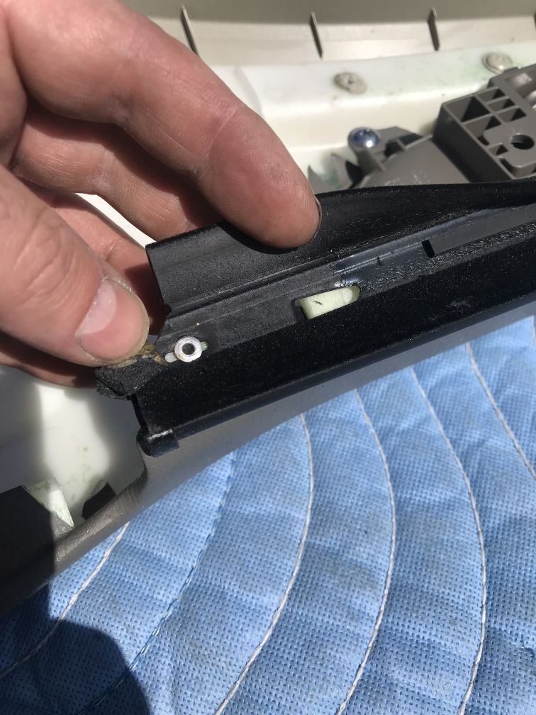

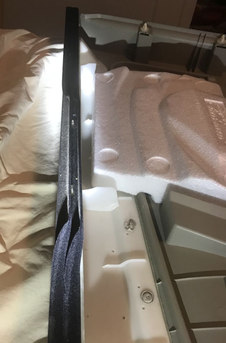

I've searched extensively and cannot find anything on this issue - apologies if I missed something.

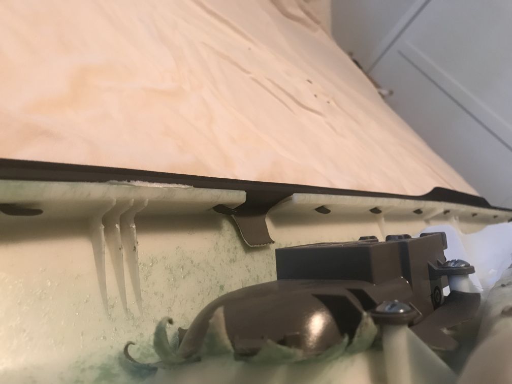

The inner window seal/felt on my 2003 coupe has folded under the window. Pics are of drivers side, but both sides have the issue. I pushed the passenger side back up but it's just not right. I'd rather replace them.

Ordered just the felts from InfinitiPartsDeal, which lists them as separate parts for later years, but they cancelled the order - no longer available. Tried a dealer too, but they wanted to sell me an entire, new door panel. So I found some 2005 door panels on ebay that had good felts, and swapped them over. There are rivets on each end, which were easy to drill out and replace.
