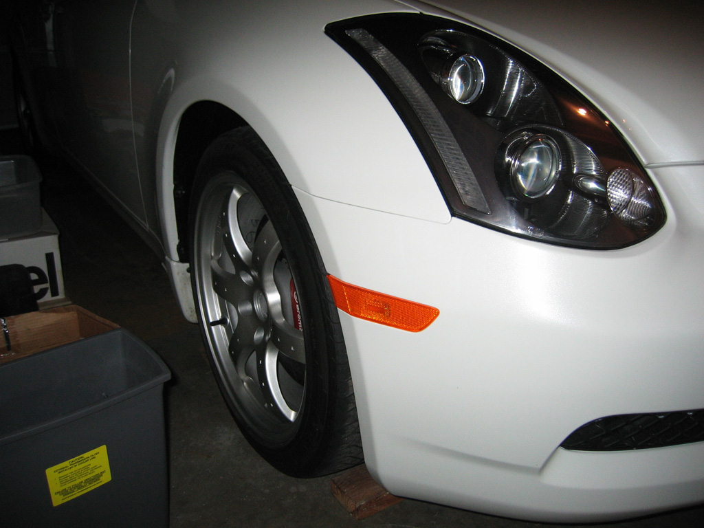

The startup time takes about 10 seconds. With the stock ballasts, they start up a bit brighter than baseline, then gradually comes down. With these, the startup brightness is like the usual 35W, then it gradually increases in brightness.
Pic of the car finally fixed. My smoked corner was destroyed, and they had to replace the bumper and fender, as well as fix the rim... twice.

sweet setup E_K. sweet red brembos too.
