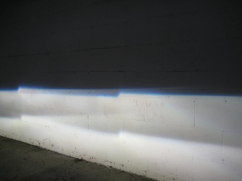

Originally Posted by Yume
I could've sworn these were clear, maybe i just can't tell the difference. Oh well they work.
actually i don't think it is possible to adjust the rotation of the horizontal cutoff line without opening the headlights. The only way to adjust it is to mess with the sheilds. The 3 bolts only allow for left/right and up/down.
Maybe my wording was unclear, FX lenses are either clear(mostly) or frosted, none were ever fresnel like the g35 lenses with the rings in them. Yours could very easily be clear, and from the looks of it, they are.
I wasn't referring to the rotational adjustment I know that isn't adjustable without opening the headlights, I was talking about the left to right adjustment. I think your driver's side headlight is pointed too far to the left. The steps appear to be too far apart at that distance. An easy way to check if the lights are pointed directly ahead is to drive towards a wall with the projectors on, and see if the cutoff steps move close together or not

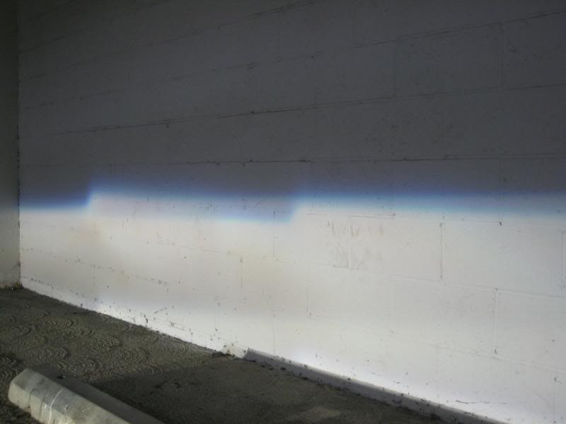

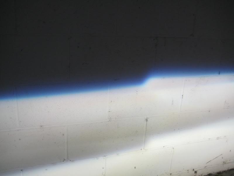

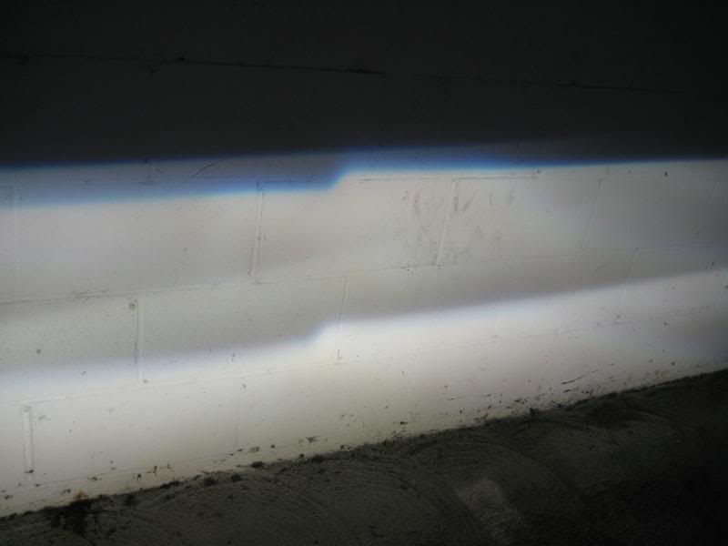

Pictures of cutoffs on the wall as promised.
Question for the lighting guru's, if you look at the pictures with the the fogs and headlights, you'll notice that the fog are a lot bright than the headlights. at first i thought the bulbs were bad. So i switch the bulbs from the fog to the headlights and i still get the same results. So that leads me to either the ballast for the headlights are bad or the lens aren't really that great. The ballast on both headlights are my original ones and the ones on the fogs are extra ones i bought. Do you guys think it could be the ballast? or lens? or something else?

Old Jan 18, 2008 | 01:46 AM
  #36
GreenGoblin's Avatar
The goblin resurrection
iTrader: (66)
Posts: 25,863
Likes: 187
From: In my garage
Did you mess with the cut off shield's on either set of projectors

the fogs appear brighter because the light from the lowbeams are stacking on top of the foglight output, making it appear brighter. If you turn off your fogs you'll see what I'm talking about. The top projectors look pretty well aim althoughI think they are still too far apart, but that bottom driver's side projector is severly rotated

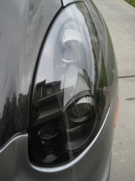

Old Jan 27, 2008 | 02:40 PM
  #39
ON's Avatar
ON
Joined: Jan 2006
Posts: 2,800
From: The Other Side of Riverside
BUMP...cuz IvoryGT and WRAH did it.

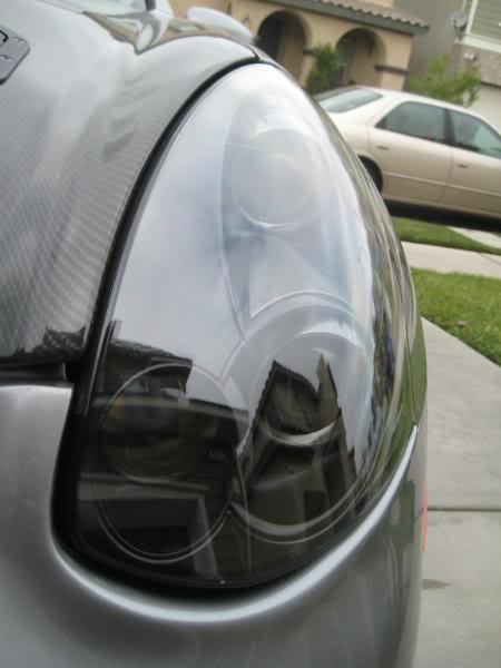

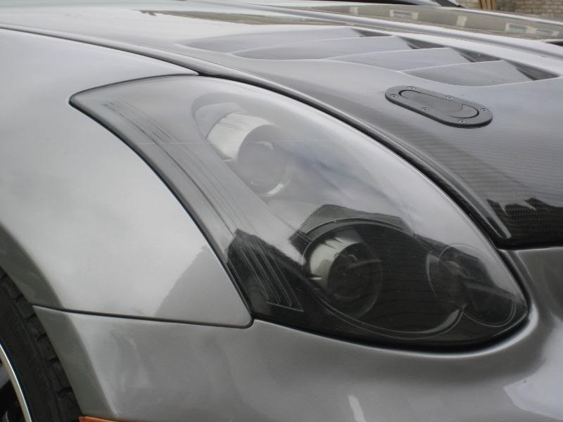

And also some updates.

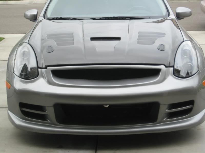

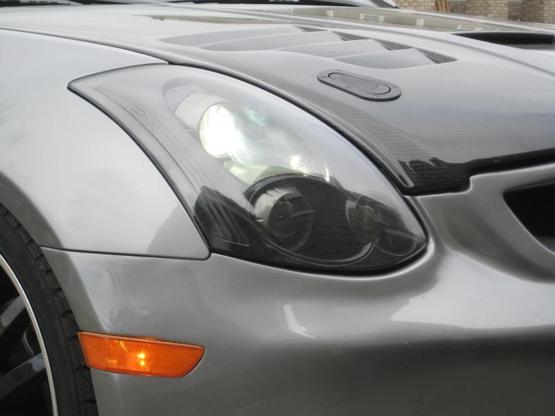

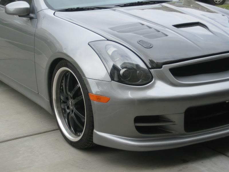

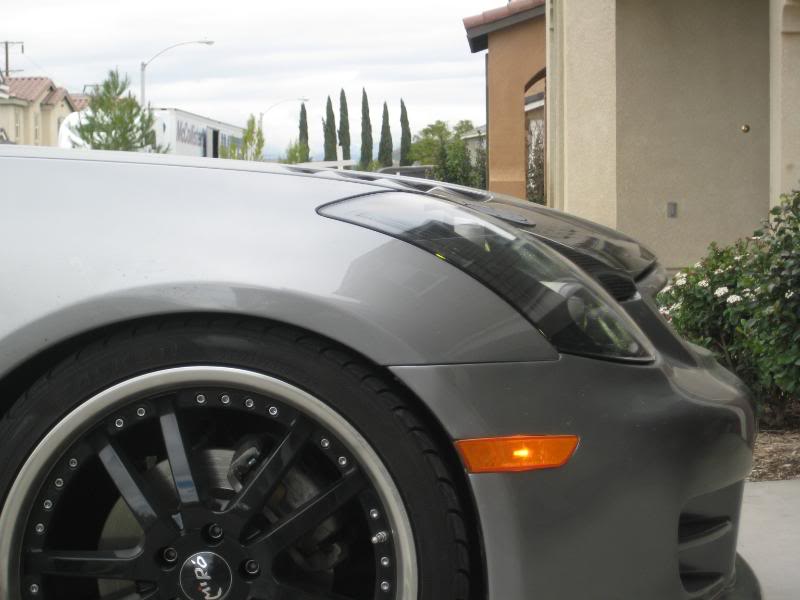

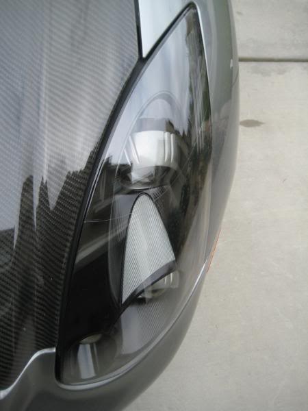

Decided to fix the messed up cutoff on the fog lights and repaint the shroud yet again. No pictures of the new cutoff, but it's much better now. Trust me.

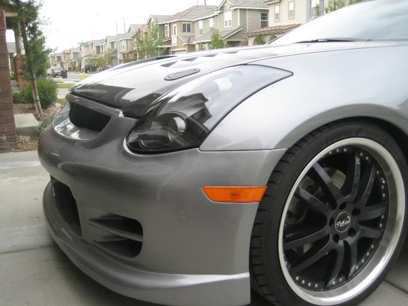

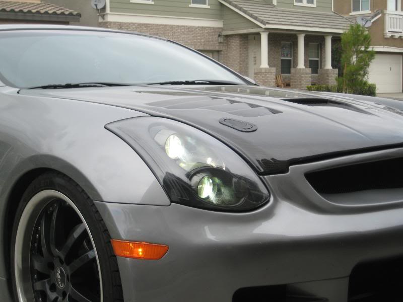

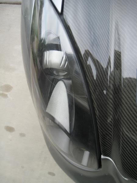

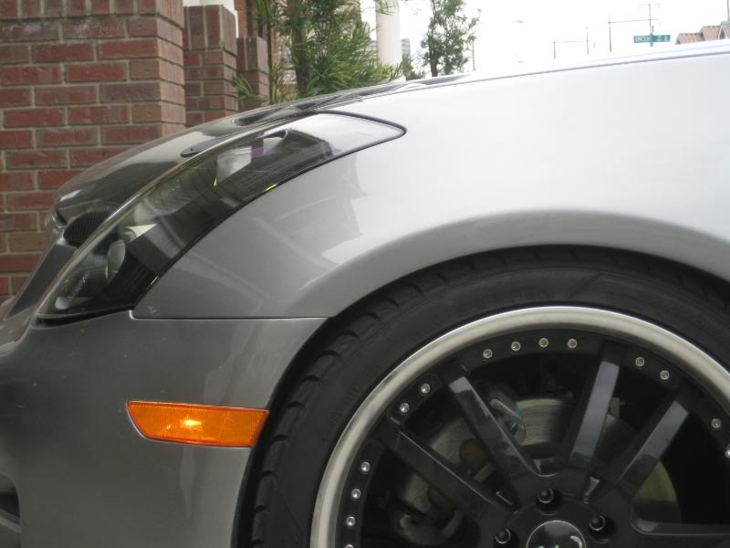

New pictures of the shroud. Hai, I decided to take your advice and paint the shroud to show the projectors more.
I'm not good at color matching, but its good enough for me.

Old Jan 27, 2008 | 03:33 PM
  #40
redlude97's Avatar
iTrader: (25)
Joined: Feb 2006
Posts: 1,911
From: Seattle, WA
nice work, the shrouds look much better now and people can see the work you did!
