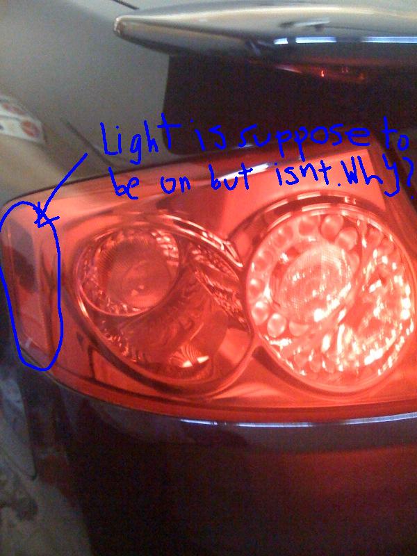

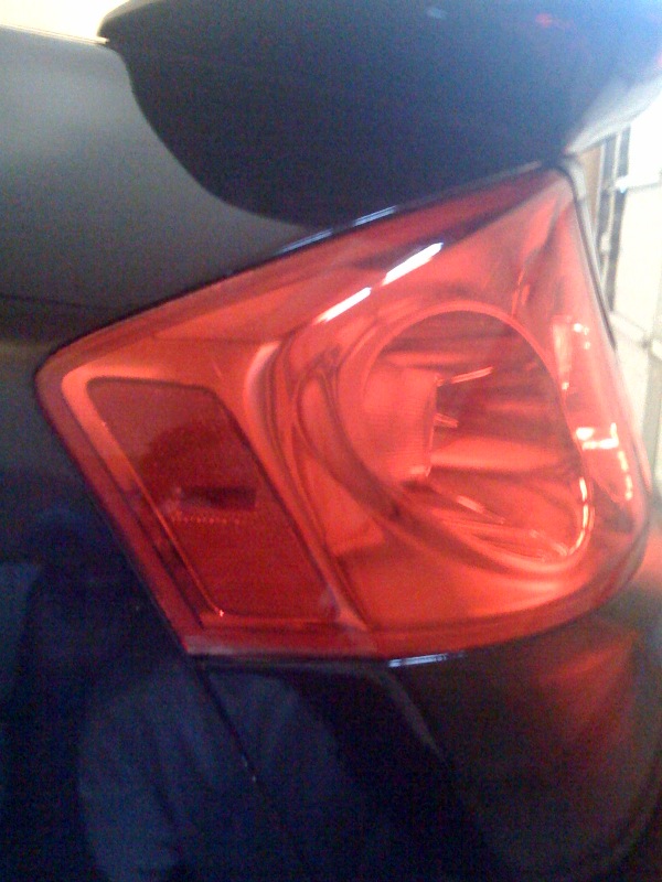

ok so i just realized that an LED in my taillights isnt working like its suppose to be. the led that on the side of the tail light isnt turning on in my taillights, and not just one in both of them. does anyone know wat the problem could be?
ohh by the way i have 05 coupe tail lights. Thanks
heres some pictures of what i was talking about. does anyone know what the problem could be???
Attached Thumbnails Rear TailLights LED not working-rear-light.jpg   Rear TailLights LED not working-rear-taillights.jpg

Seems like the bulbs may have burned out, start by pulling them out and taking a look at the filament. Yes, the sides are incandescent...

i may be wrong, but I think that part uses regular bulbs. They may be burned out and need to be replaced.

how do i pull out my taillights and wat kinda bulb goes in there??

they are #194 bulbs. you will need two total, one fo each side, not led's you can get them anywhere.
there is 3 8mm nuts holding each tailight in. two in the corners and one more towards the center of the trunk.
you will have to remove the rear carpet section. just be careful when you pop out the black holding clips, make sure you pull the center of the clip first then the whole clip comes out
its very easy to change, shouldnt take more than 5 minutes per side
good luck
