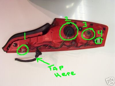

from looking at your pixs you already have jdm taillights. your blinker are amber when blinking correct? also you dont have a small bulb in the corner of the lights (#4 on the pix). if you removed them already they should look the pix attached minus #4.
1 is the reverse bulb. twist and remove to access bulb.
2 is to the led plug.
3 turn signal bulb. twist to remove also
4 is only in the usdm models, you shouldn't have this.
all you need to do is cut the wires from #1 near the plug, after the seal.
"after the seal"? canu elaborate on that pls?
also thanks for the pictures buddy. i was hoping i could find some which could give me an idea what its gonna look like. i think ill end up geting that done..unfortunately
doesnt look to bed on the red skyline.. but blue one looks awful..

the seal is a rubber circle that stops water from getting into the car. in my pix you see a wrote "tap here" and the seal is the black rubber on the right of that. i say tap there so your wires will be inside the car unexposed to the elements. but you can tap the wire anywhere after the seal to the actual plug.
and just like ERKLEP said, you just need to twist the socket to get the bulbs out of the housings.
good luck.
i should really take the housing out again and take a look again. take pics too this time.
