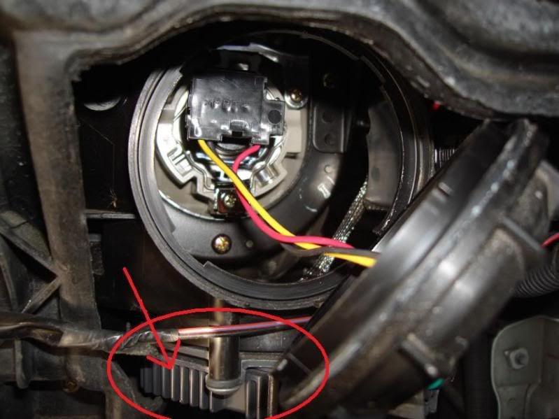

ok so my car is apart outside and ive got the bulb in my hand. Turns out the cheapo before me decided to put H1 bulbs in (which explains the yellowish color). Now im scared that maybe he took out the ballast for some reason. How can i tell before i go out and buy 200$ HID bulbs?

your lights wont run w/o ballasts will they? they are silver square things attached ot the bottom of the headlight housing with a bunch of wires coming out of them

behind the headlight underneath the headlight is a box with fin on the sides.this is ur ballast. If u dont see this that means he took it out.

is this the ballast?
