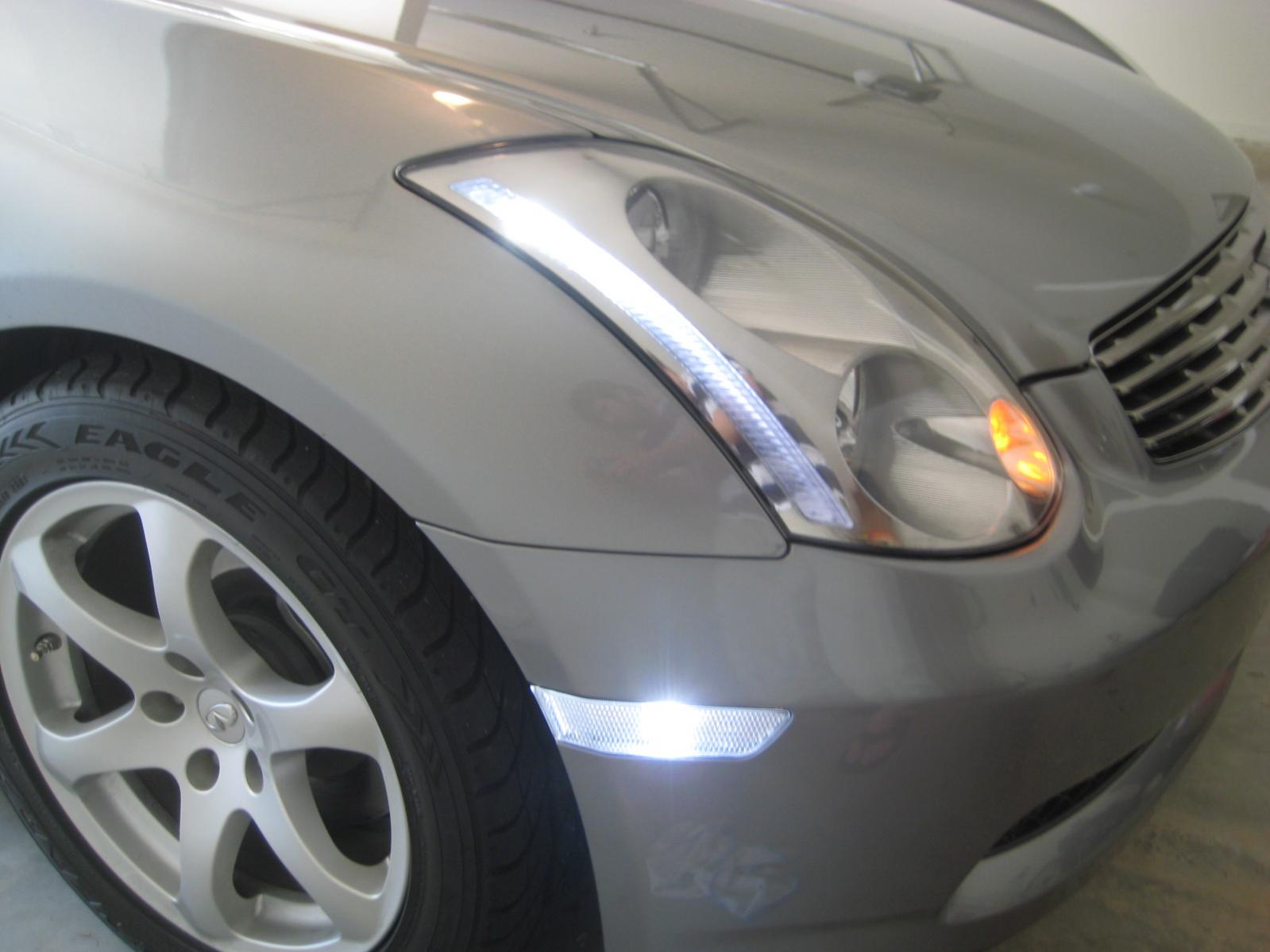

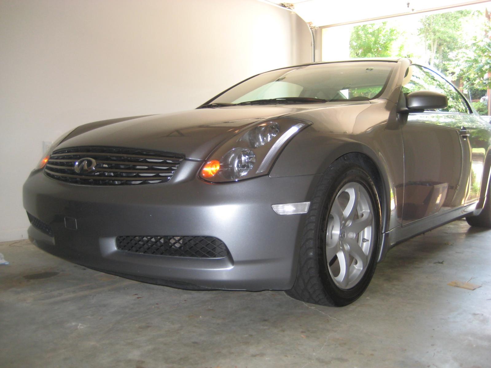

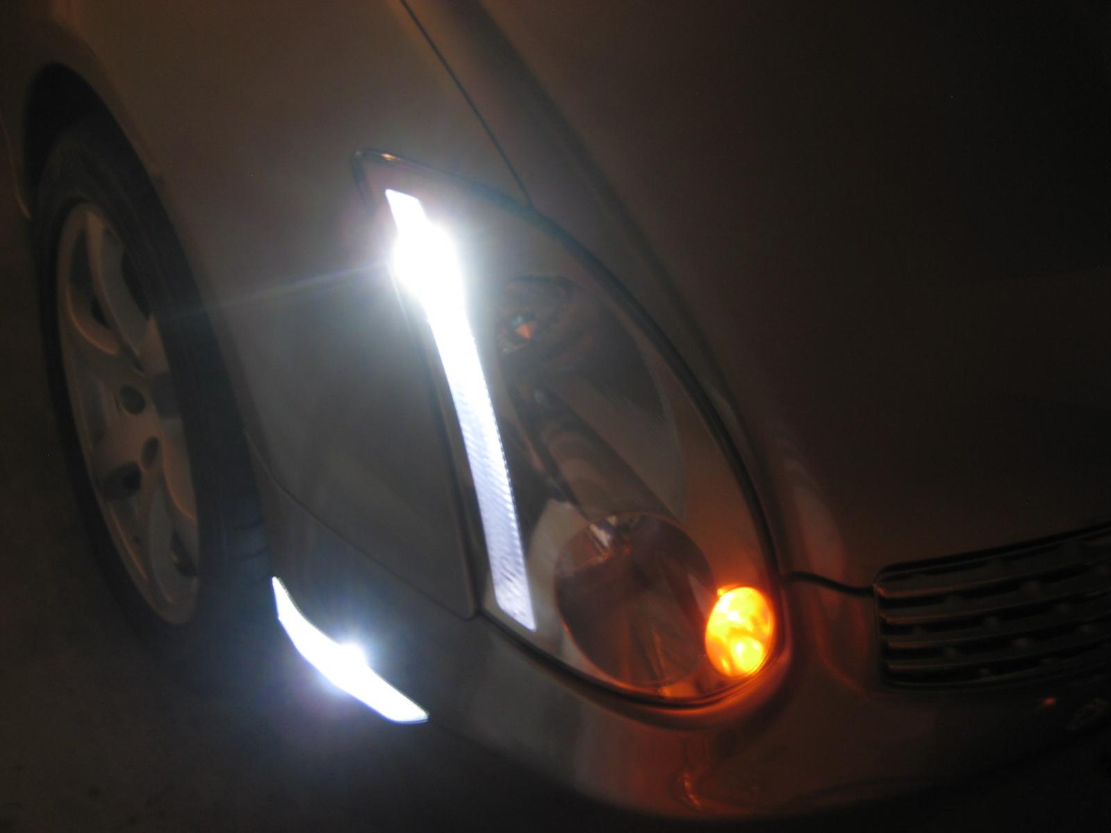

No more yellow.
Got some clean used 05 lights off of ebay for $450. I payed to much, and they showed up with one of the tabs cracked... but the seller was cool enough to refund $50 for that. I took the light to my dealer and they epoxied the tab for the free free. It should be alright for a while.
I'm planning a amber/white LED strip blinker/clearance mod, but here are some pics on the clean lights with some 6000k single LED 194s in the clearance strip and clear corner.
Oh, and don't trash my base model wheels. I'm working on it.
