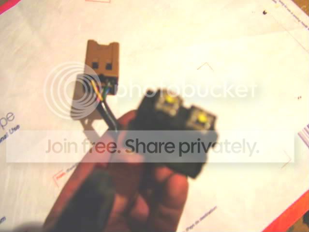

That's pretty awesome. Thanks! I'm thinking I'll just find some orange LED's so that I don't have to swap everything out. It really bothers me that that light doesn't come on. The light that shows that the seats are on works, but the illumination for the switch itself is out. Thanks again!

So i read that walkthrough and I'm wondering a couple things. What size led do i need (3mm maybe?). Also, would i need a resistor or could i just plug it into the power source without one? Here's a link to what i was thinking about getting: http://cgi.ebay.com/50p-3mm-SUPER-BRIGHT-ORANGE-LED-LAMP-13Kmcd-FREE-SHIP-/350084371454?pt=LH_DefaultDomain_0&hash=item5182a793fe#ht_4130wt_689

you will need a resistor on each led . 3mm will work as well as 5mm and superflux . might wanna get some quality leds or you will be replacing often .I can send u some cree amber superflux and resistors if you need . Best amber leds on the market

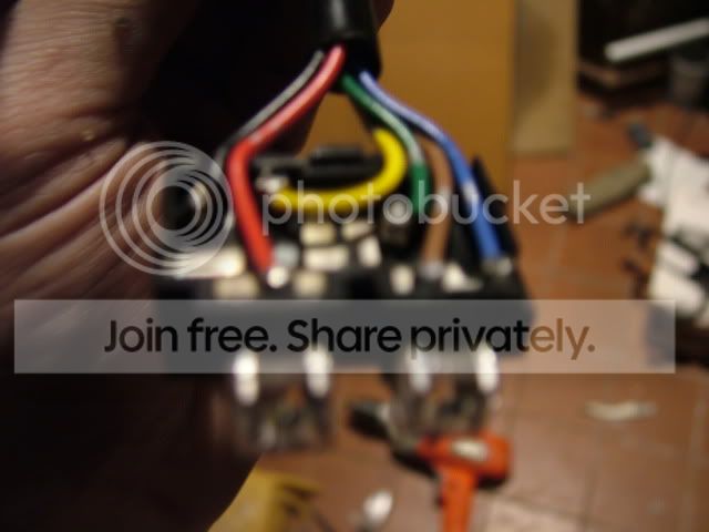

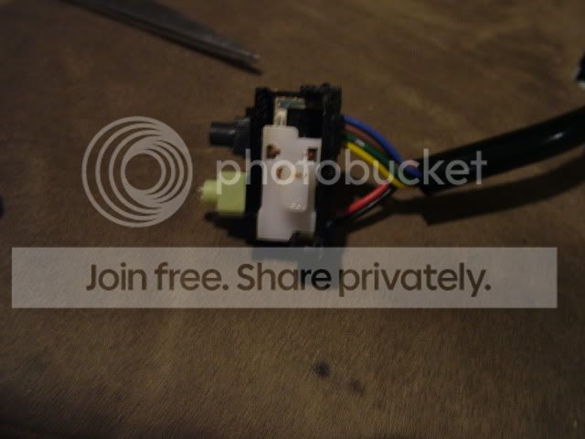

Ok, so I had no problems getting the center console apart or getting the heated seat buttons apart except... when I seperated the switch cover from the internals of the switch, the white plastic part (seen in the pictures in the link above) popped out (on both of them despite being careful). I lost one of the small springs (from the first one that popped out) and I'm not sure how the white pieces go back together on the switch. Anyone have any pictures or directions on how to re-assemble the switch internals? Also, I'm trying to think where I can get another tiny spring. I searched my whole garage and couldn't find it. Things always seem to complicate themselves for no good reason... Thanks for any help you guys can give.

Anybody know how the interior part of the switch (the white plastic piece) goes back together? Or could I just solder in the three pronged metal piece to the connections?

it just sits in there . The notches fit the shape of the housing so it can only really go in one way .

I'm wondering if the spring loaded part serves a purpose. When one of the switches came apart the spring portion disappeared. I'm just sort of wondering if soldering in the triple pronged switch to the connections would fix it or if I should just buy new switches. Thanks again for the assistance and the LED's work great! Also, any ideas on where to get new switches if I need to? I've looked on E-bay and it's hit or miss as to whether they have both sides or not. I'm also wondering if other Infiniti or Nissan switches would be plug and play. Hmm...
