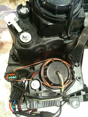

So i installed my hid fogs today and you cant close the back circle plastic part because the wires come out from the hid. To keep it closed as tight as possible i used elastics to keep it closed. What have you guys done?

mcs2000si's Avatar
Posts: 76
I said the hell with it and drilled out the back of them so I could run the wires through it. I have had no problems

That's a pretty good idea I think I might just do that cuz the elastics look stupid and are a pain if I gotta take them out again

Yeah I drilled a hole in mine.
