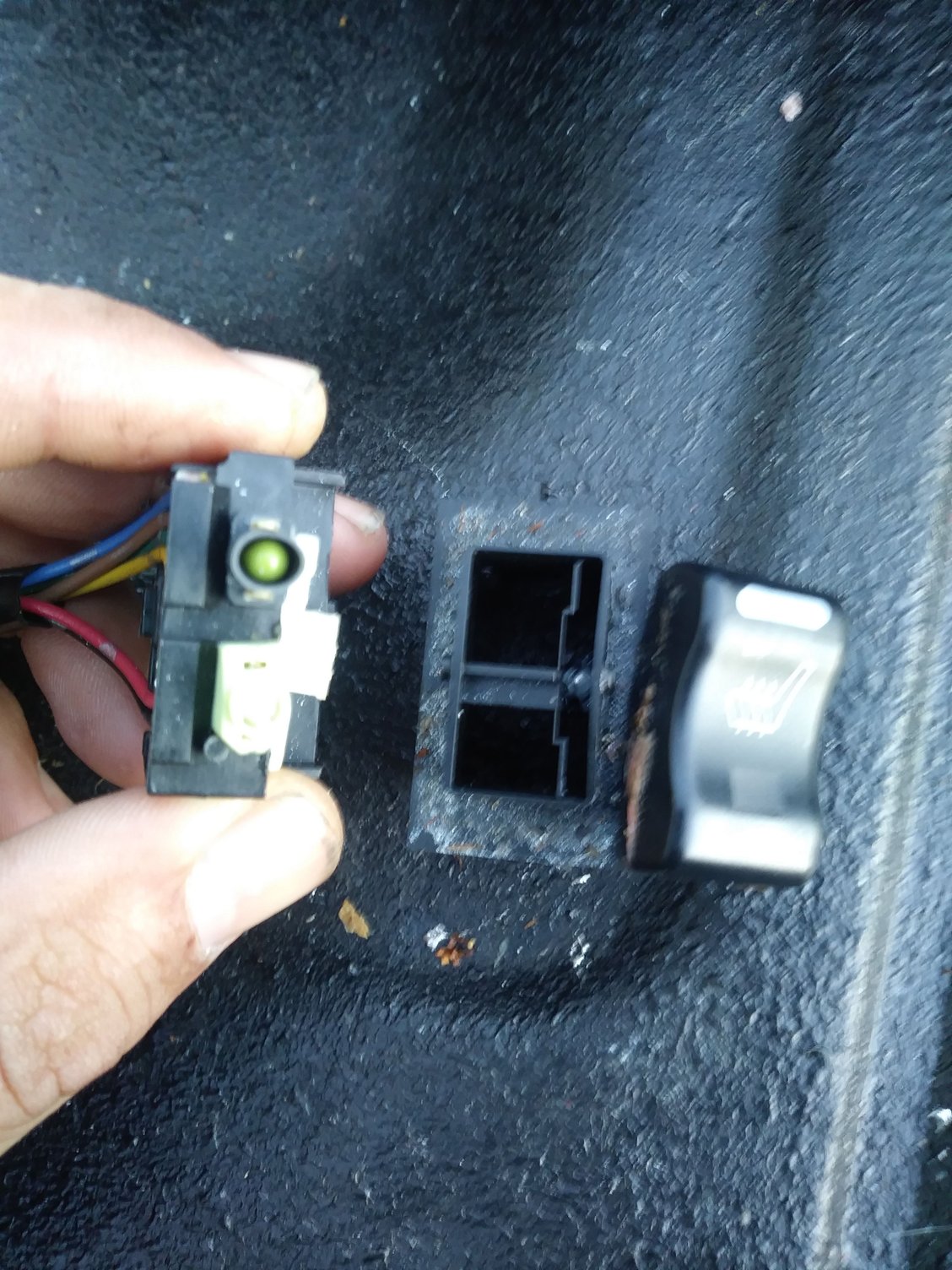

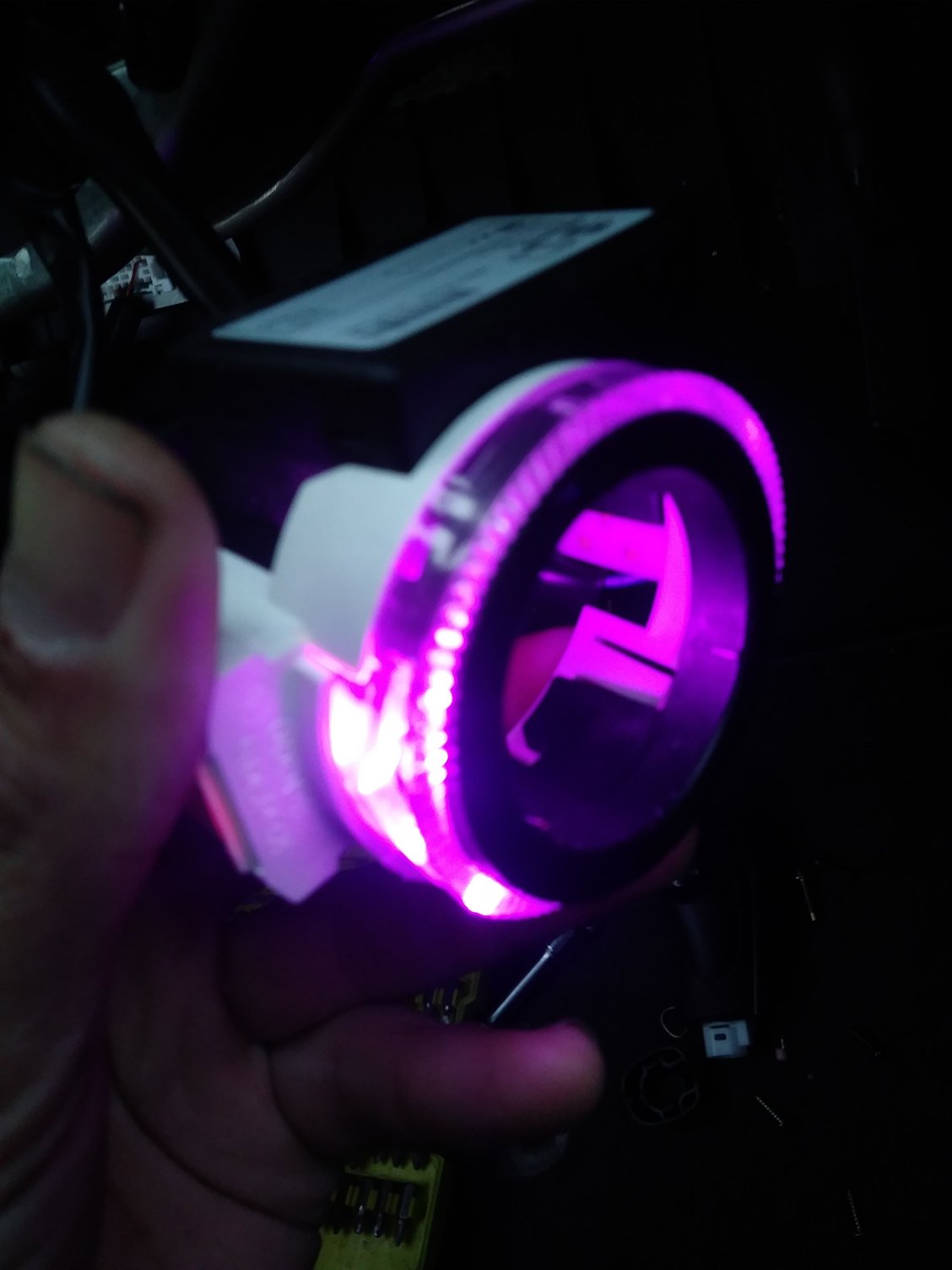

As far as what LEDs I used...
For the Cluster, Clock, Seat heat switches, Key ring, and Cig lighter, I used some "maxgtrs" Pink T5 COB bulbs. Most I had to take out of the sockets and clip the legs shorter to retrofit in.
For the Shifter I used a segment of Pink 12V 5050 LED strip in there and soldered straight to the original wires.
For the Door/Window switches I used Pink .2w 2835 LEDs.
For the Climate controls I used Pink .2w 5730 LEDs
The window thats behind the clock, I couldmt change the LCD displays color and the plastic lense that they used wont allow any of the pink light through. I need to find someone that can mould a clear lense for me or figure something else out.
