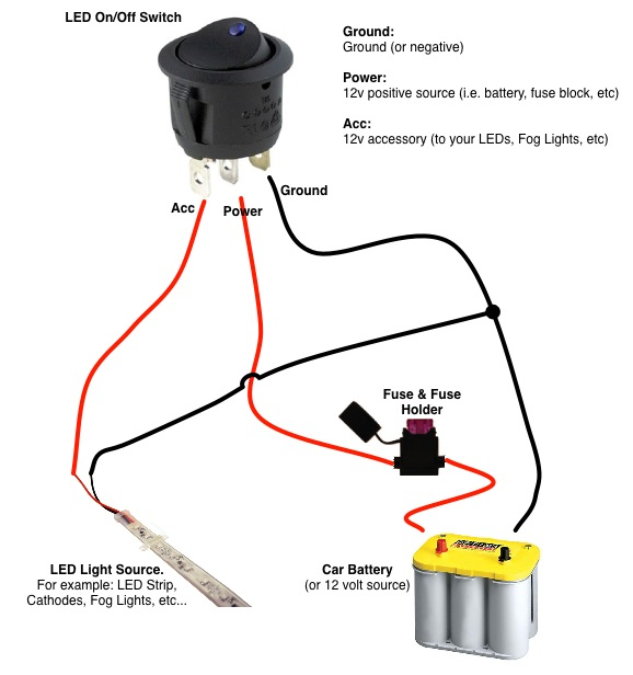

I purchased a 3 prong toggle switch and wired it up similar to how this video explains

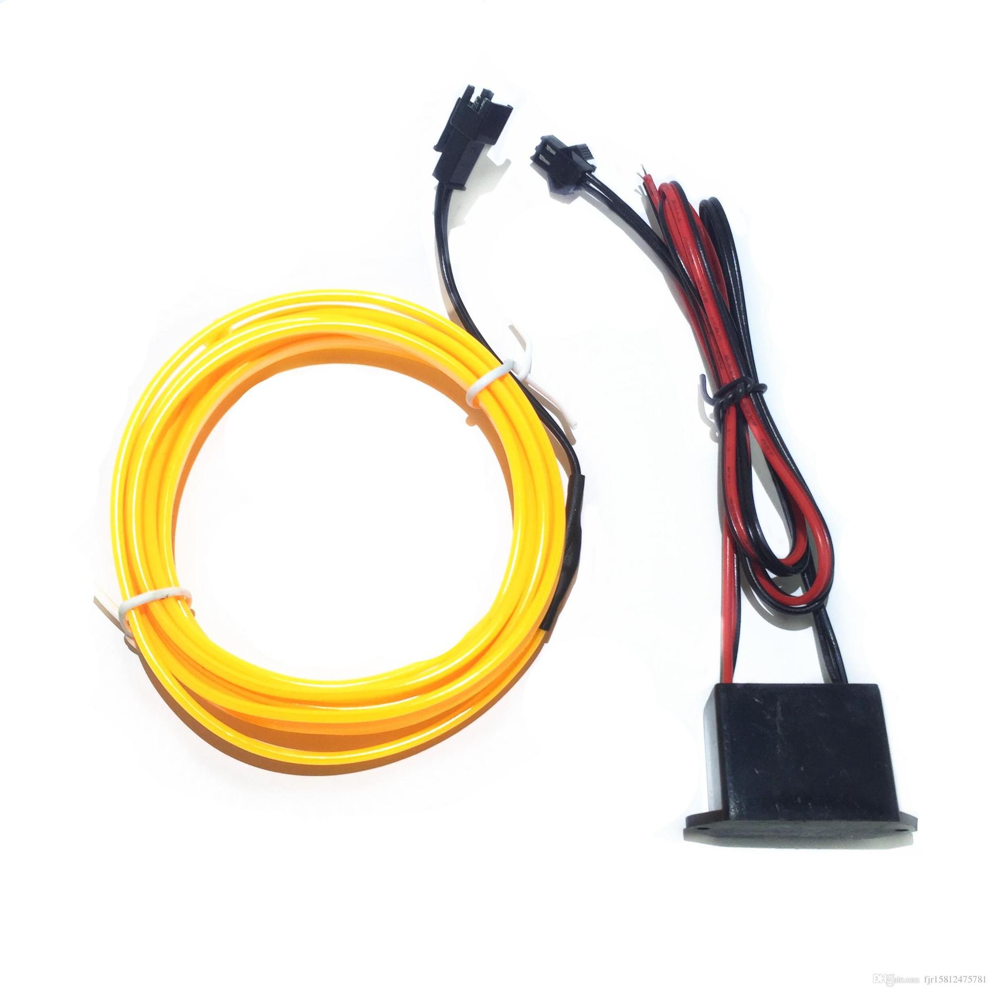

The El-wire lights I used are exactly as shown on this video

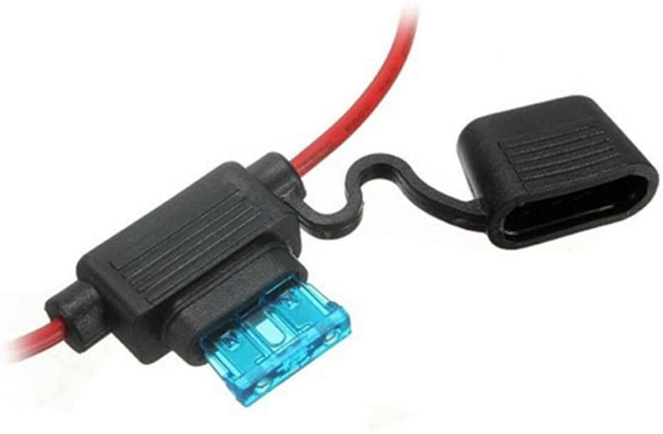

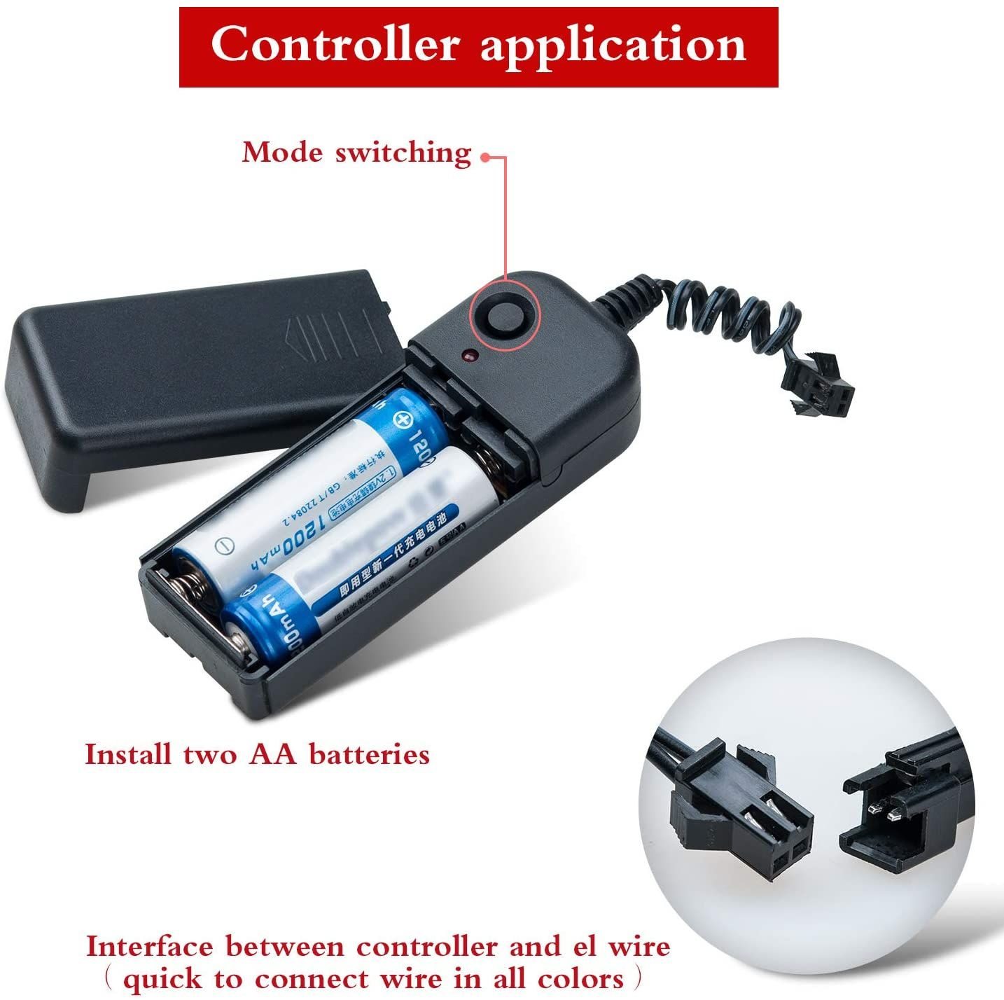

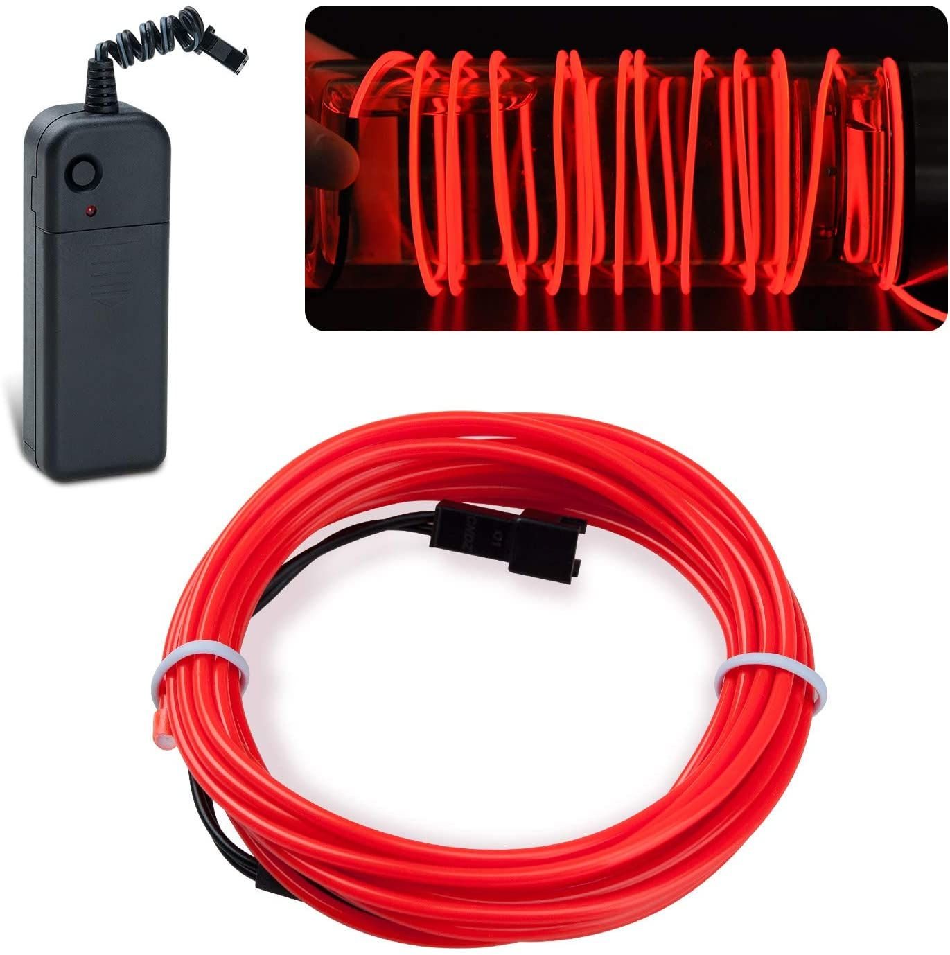

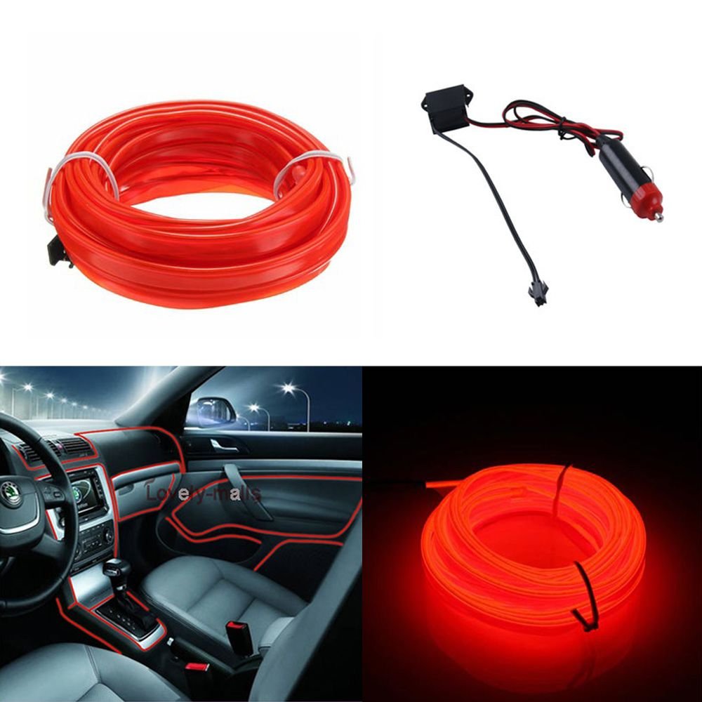

They offer a AA battery powered version and 2 12v automotive versions, 1 being a cigarette lighter powered and the other wired up to a toggle switch/Hardwired. Always use a fuse line holder as seen on the wiring diagram below.
**DISCLAIMER: I will not be responsible for anything that may happen to your car due to this modification. This is DO AT YOUR OWN RISK! If you don't feel comfortable with wiring it to a rocker switch you can just buy the AA battery powered version and just run it through your firewall and turn it on and off as you please, I just chose to have it hardwired to my car and have a nice rocker on/off switch**
Battery powered EL wire kit
