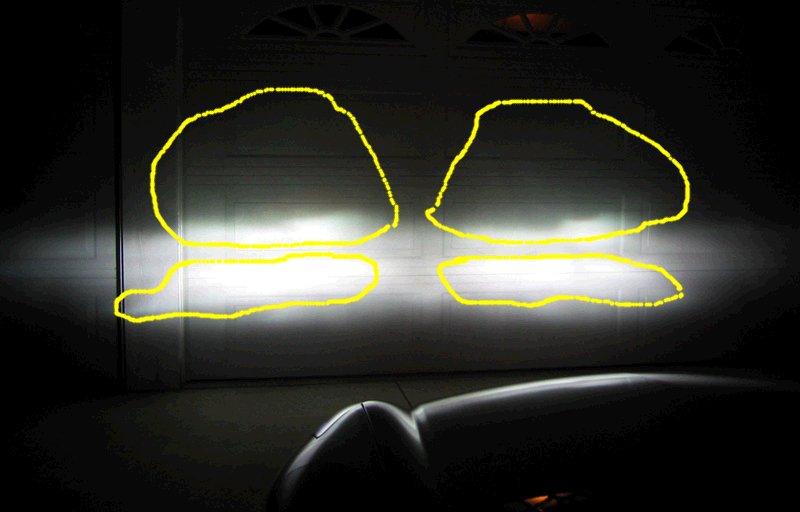

Old Oct 3, 2005 | 09:43 AM
  #20
PeteNJ's Avatar
Joined: Oct 2004
Posts: 1,148
From: Hoboken,NJ
Originally Posted by Silverbolt
Below are pictures of my HID setup. The first picture is a completely stock setup. Second is with 6000k HID lows and fogs.
The light pattern is identical.
Please see attached. You can see where I circled in yellow you have significant "Hot spotting". Also, you have "ghosts" appearing over your low beam cutoff line. If you look at the beam overall it does appear to have the same pattern but if you look closer you will see random hotspotting and flares throughout.
Old Oct 3, 2005 | 10:04 AM
  #21
PeteNJ's Avatar
Joined: Oct 2004
Posts: 1,148
From: Hoboken,NJ
You're right... a 55w H4 halogen bulb produces more light output than a 35w H4 HID bulb Are you sure you dont want to retract your statement?
I never said wattage has anything to do with overall light output. I will standby my statement that performance of your FOG/Highbeams stock was better than what you have now.
Fog lights are designed to throw wide useable light low onto the foreground. With your HID "upgrade" you are pushing out more scattered blue light into the fog which will cause more glare to come back at you. Highbeams? You don't have them anymore.
