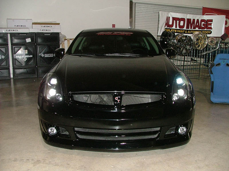

This is what they look like on the car.
Gee3five,
How is just the low beam output?
