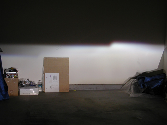

Originally Posted by PeteNJ
Gee3five,
How is just the low beam output?
I don't have any problems with the low beams...I can see fine...here is a pic from tonight. Car is outside of the garage front door.
Is that with the lights on the car? The left side seems lower than the right. Or is it the fog light that is one as well?
Old Sep 27, 2005 | 09:15 AM
  #70
PeteNJ's Avatar
Joined: Oct 2004
Posts: 1,148
From: Hoboken,NJ
Outdoor 25ft shot would be awesome The aiming appears to be a bit off?
