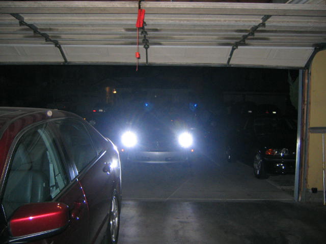

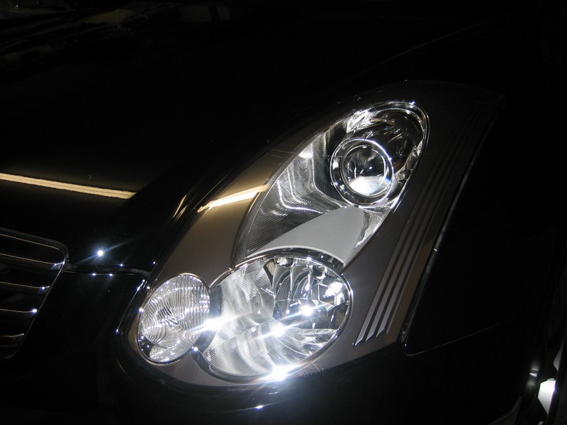

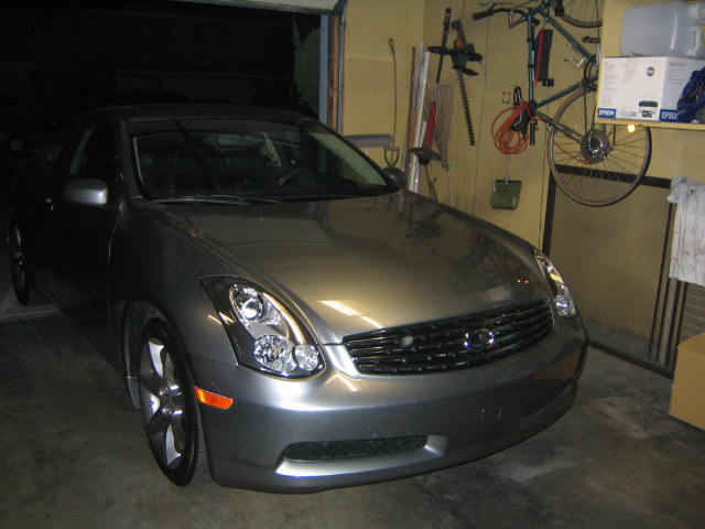

Ok... finally got a hold of a camera. I took some quick pictures. I will try to take some better ones tonight.

Originally Posted by Fini
So, Got my car back today! doing this install was harder than I thought it would be. First off, it took me a lil bit to take off the bumper. THEN, took me FOREVER to figure out how to take off the the stupid wiring harness. THIRD! the passenger side wires were SOOOO short, I had no room to pull out the housing so I would have more room for my hand. I finally got it off after I dunno how long.... but I need to redo the bumper. After i screwed everything back on, I noticed some foam was sticking up behind the bottom grill.
After about 3 hours of work... lights look awsome!!! I modified my stock bulb, but will have some osram D2S coming in soon. got piaa mirror bulb in the blinker, and silverstars in the fog. I know its not a good match, but I don't plan on using the fogs much anyway. these projectors are way better than the reflector housing! I will post pics as soon as i can borrow a better digicam. as you can see, my pics weren't such good quality at the top.

and Fini, you need to get beam patterns, like 20 feet away and 1 picture next to like a long wall.

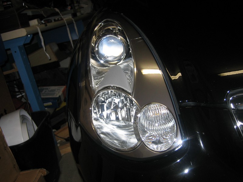

06 headlight conversion
Hello All,

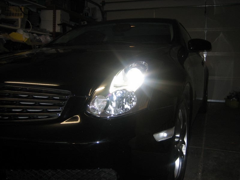

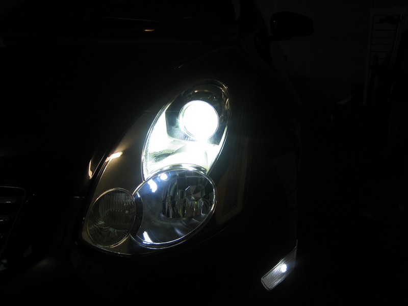

I just installed the 06 headlights on my 04 coupe last night. And i agree with some of you that the most difficult part of the install was removing the wiring clips, not much room to move around in there.
I have the following bulbs in my car:
McCulloch D2S 6000k HID bulbs (not as good as the phillips Ultinon, but only cost me $100 for the pair)
PIAA H1 4000K xtreme cool white plus bulbs
PIAA 7440 Chrome orange beam for the turn signals
PIAA GTX 194 for the city light

Thanks Chad for hooking up the headlights!!

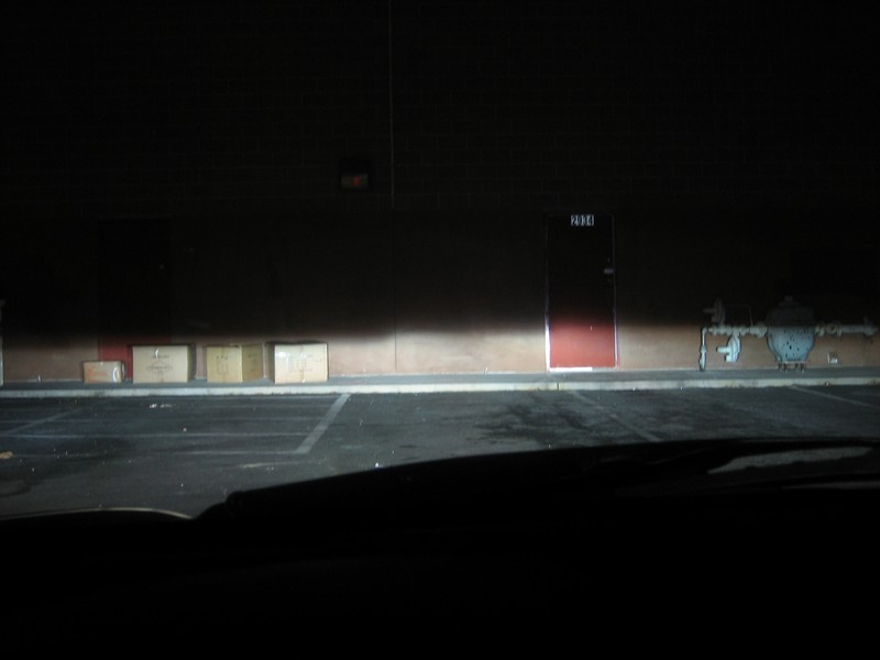

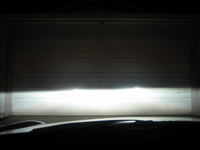

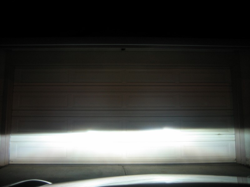

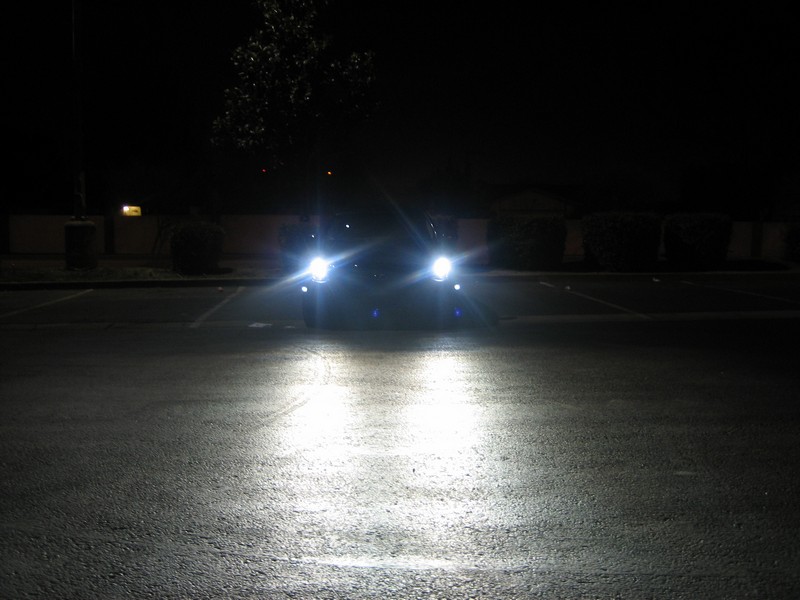

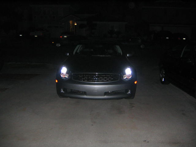

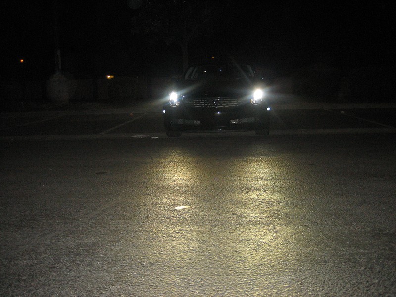

Got a chance to take some more pics.
Anyone notice that the right is aimed slightly higher? I've read that other people has this problem also? is it normal?
Attached Thumbnails Can't wait to put these on!-img_1365.jpg   Can't wait to put these on!-img_1367.jpg   Can't wait to put these on!-img_1372.jpg   Can't wait to put these on!-img_1376.jpg   Can't wait to put these on!-img_1378.jpg

The lights look great Fini. I believe the right headlight is aimed a tad higher to assist with lighting up road signs.
they are meant to be that way. the left is actually a lil lower so that you dont blind oncoming traffic on the left of you.
if you see RHD cars, it's vise-versa. and the beam pattern looks good to me. mine looks the same!
