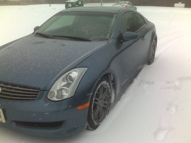

Update: Snow Testing
So we got about 6" of snow & freezing rain today at home, took freaken 2 hrs to shovel, anyways I took the G for a test drive at noon today and here are my observations:
- The roads were not plowed or salted and so I was driving on 4-6" of powder freezing rain crap (extreme test conditions, local roads & no traffic)
- The G is well weight balanced 54/46 and no very little fish tailing and VDC keeps the car straight mostly, I had some fish tailing with VDC off. That feature is a life saver.
- The SLIP light kept coming on continually and I could even hear the VDC mechanism working hard, it constant came on and off and every time I accelerated it would kick in too, kind annoying, but kept me straight. In a stretch that I could normally reach 40 mph, I could barely get up to 25mph because of VDC. Felt like I was towing a semi.
- The ABS kick on everytime I stopped, but it stopped in enough time and never over shot.
- During turns the VDC kept kicking in so much that I could not even make the turn, had to turn it off so I could actually finish making the turn, with a little fish tailing.
- The steering is not too bad for an RWD, I definitely understand the advantage a FWD has, but as long as I kept turning the steering wheel back and forth to compensate G wewnt where I needed it too.
- I did not get stuck anywhere.
Overall, the snow donuts in parking lots were way too much fun, until the freaken towny cop showed up and I told him exactly what I was doing and he left me alone i.e. "testing the tolerance and safety of my new car in a safe location so I can be a better driver on the road under similarly conditions."
Basically, the G is not good for extreme winter conditions, but with the right tires, VDC and a light foot, it does as well as any other car. I
Some random camera phone pics below.
Attached Thumbnails My Winter Setup-img00189.jpg   My Winter Setup-img00191.jpg   My Winter Setup-img00192.jpg   My Winter Setup-img00193.jpg
