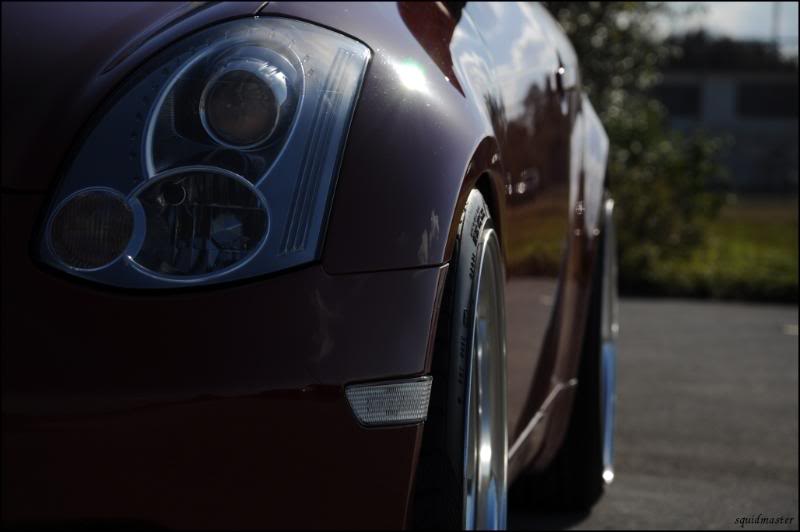

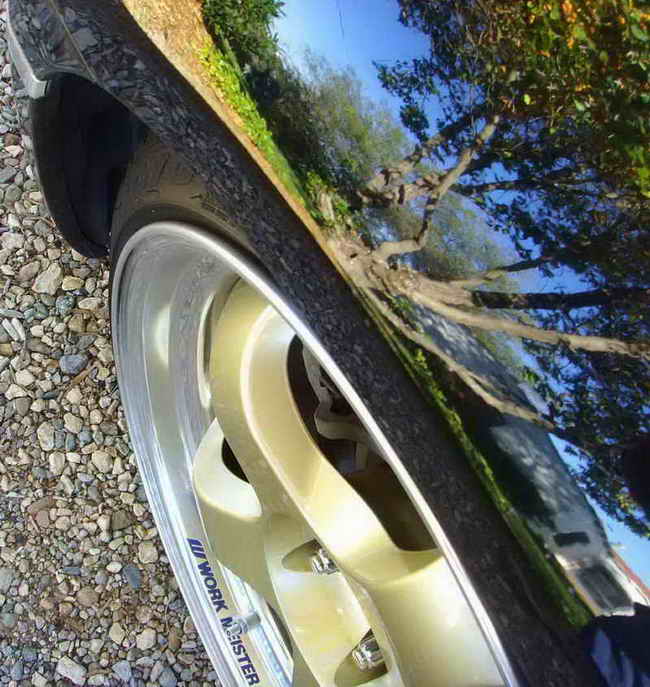

im running 235/35 fronts and 265/30's rear and its a pretty aggressive stretch. ill post a front and rear shot. these pics arent that great but the tires do leave the rims exposed a bit.

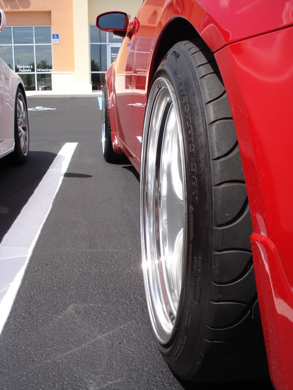

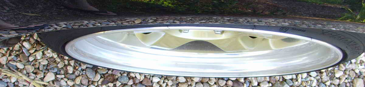

how bout like this?
This was before i dropped the car..only difference is my rears are 19x11 w/ 275's..but u get the idea..
