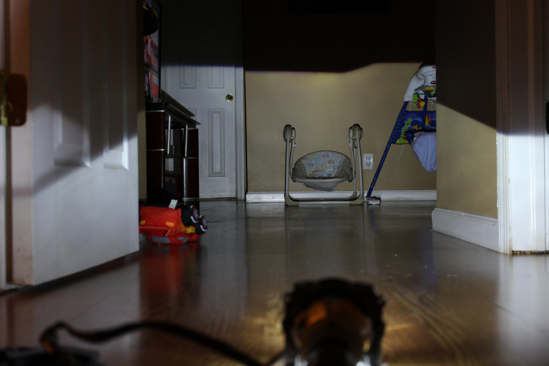

So, as promised, here as picture from the stock 06-07 projector, plus Morimoto D2s and Morimoto H1 6.0 projectors. All the pictures are of unmodified projectors, the OEM ones I had just removed from a set of lights I just bought and the Morimotos are out of the box from TRS.
First up are the 06-07 OEM projectors:
Next are the Morimoto D2s projectors:
And the Morimoto H1 6.0:

huge difference ..
Old May 25, 2013 | 05:48 PM
  #25
DKano's Avatar
Joined: Jun 2005
Posts: 419
Likes: 20
From: Long Island, NY
Yeah, that's why I posted them. Don't really agree with the opinion that 06 projectors are so much better than the Morimotos. Not sure about the old ones but I really like the output on the new 6.0 H1 projectors and they already have that nice blue line out of the box, which was great!
