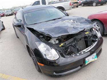

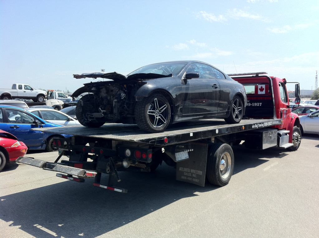

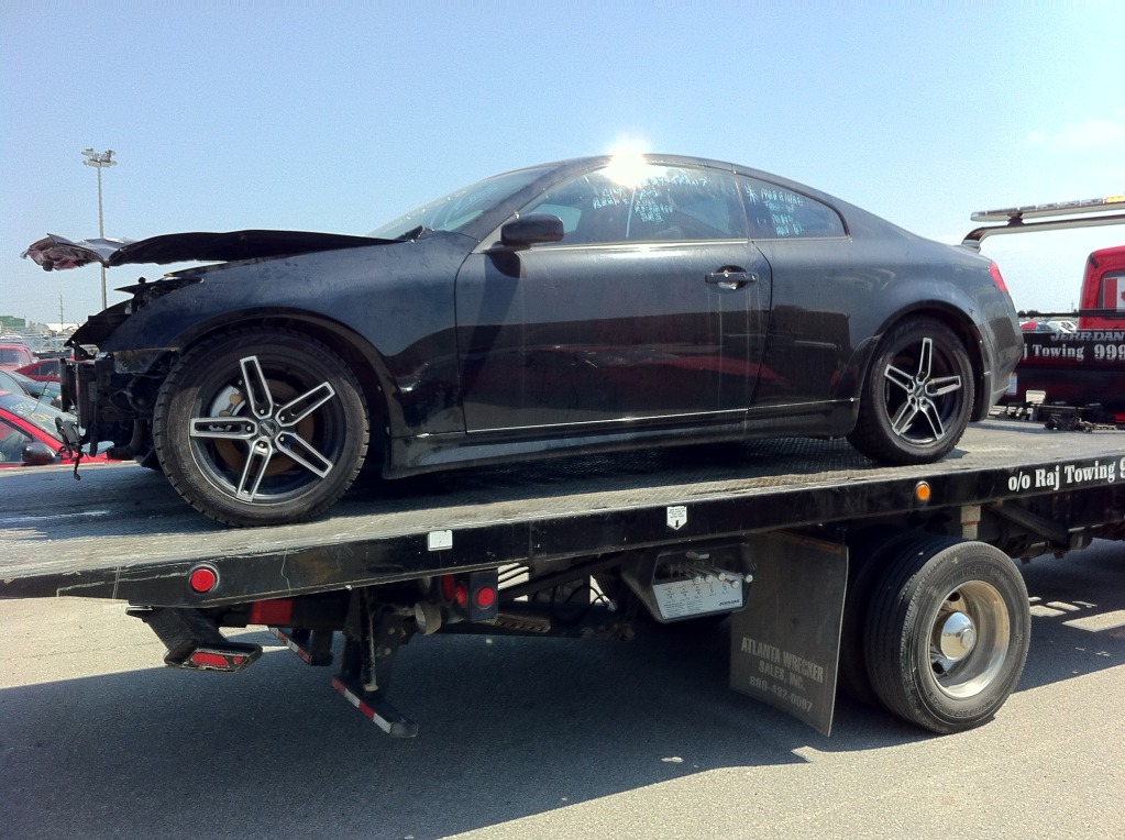

I got the car from an insurance Auction written off with no frame damage. When I saw the pictures it looked like minimal damage but after taking it apart had to buy a few unexpected things so here goes
Picture right after the accident

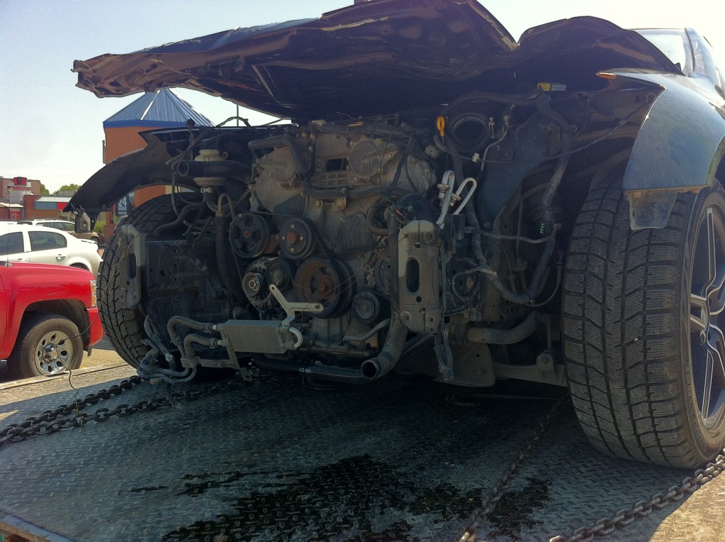

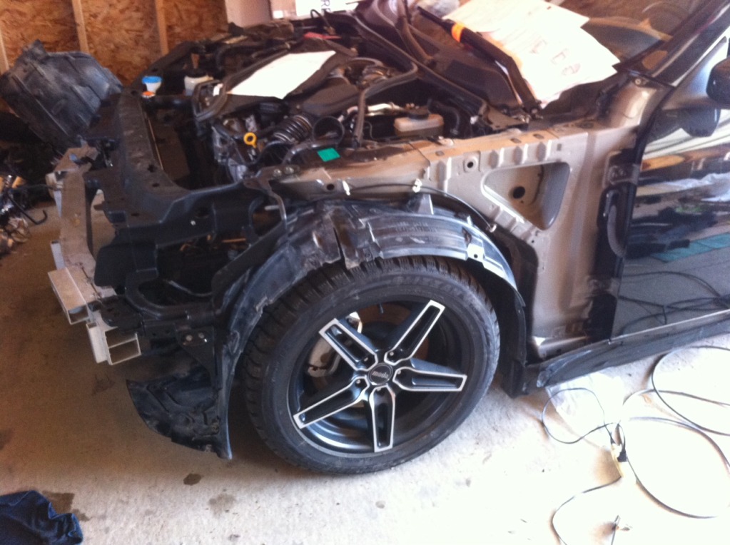

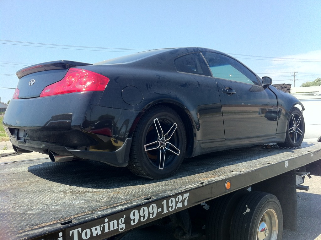

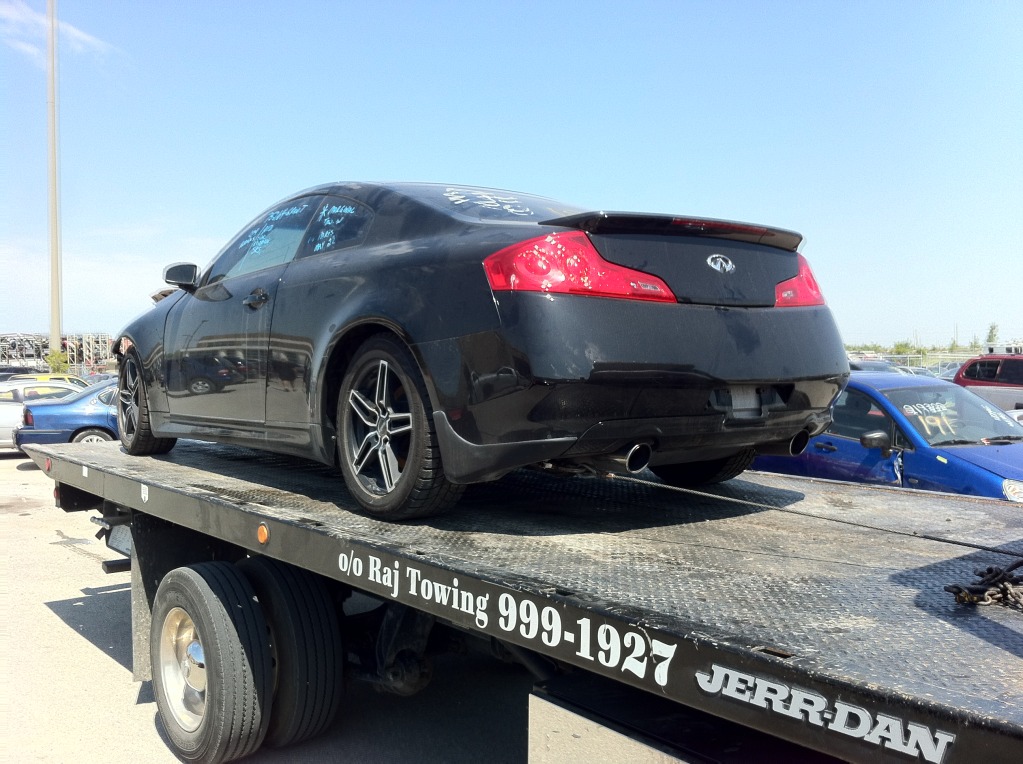

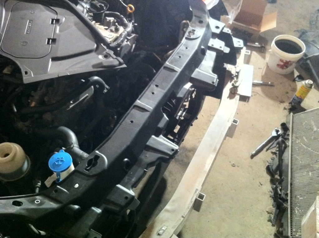

After taking her apart and towing her home
List of things needed to be replaced/Fixed
Windsheild - got from local junk yard
Power steering reservoir - got from local junk yard
Hood latch - got from local junk yard
Radiator Fan assembly - got from local junk yard
Grill - got from local junk yard
Hood and hinges - Got the Seibon OEM style CF hood and hinges from infinitipartsusa
Both fenders ( Dent removal / Painting ) - getting it done at a local body shop
Radiator Support - Ebay from D&H auto
Radiator - Denso - from local shop
AC condenser / AC lines - BEHR condenser - local shop and lines from infinitipartsusa
Air intake - Ebay - Injen CAI
Headlamps - Ebay nissan Dealer got OEM 06 set
Driver side Air bag - - got from local junk yard
Both front seat belts - - got from local junk yard
Air bag module - Sent to company to get Reset

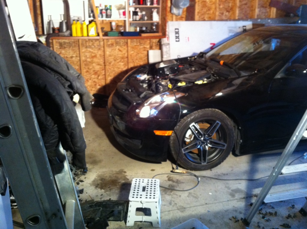

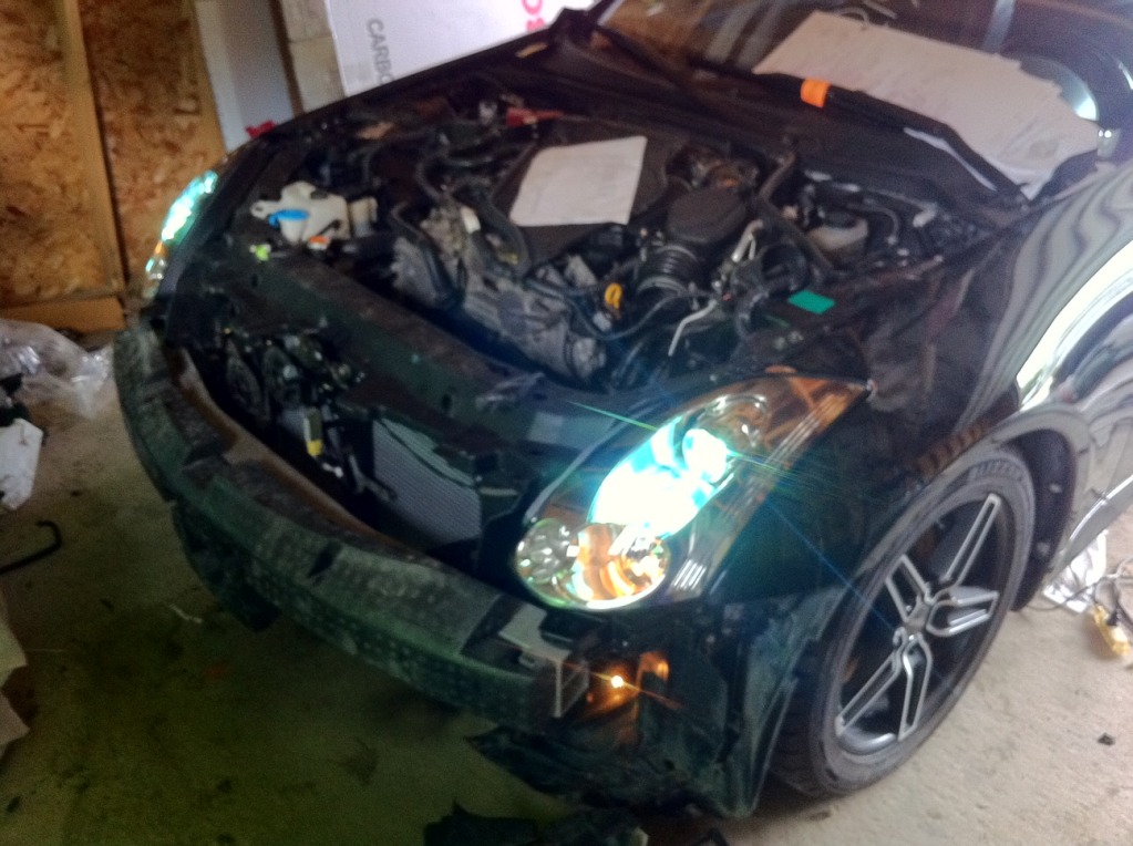

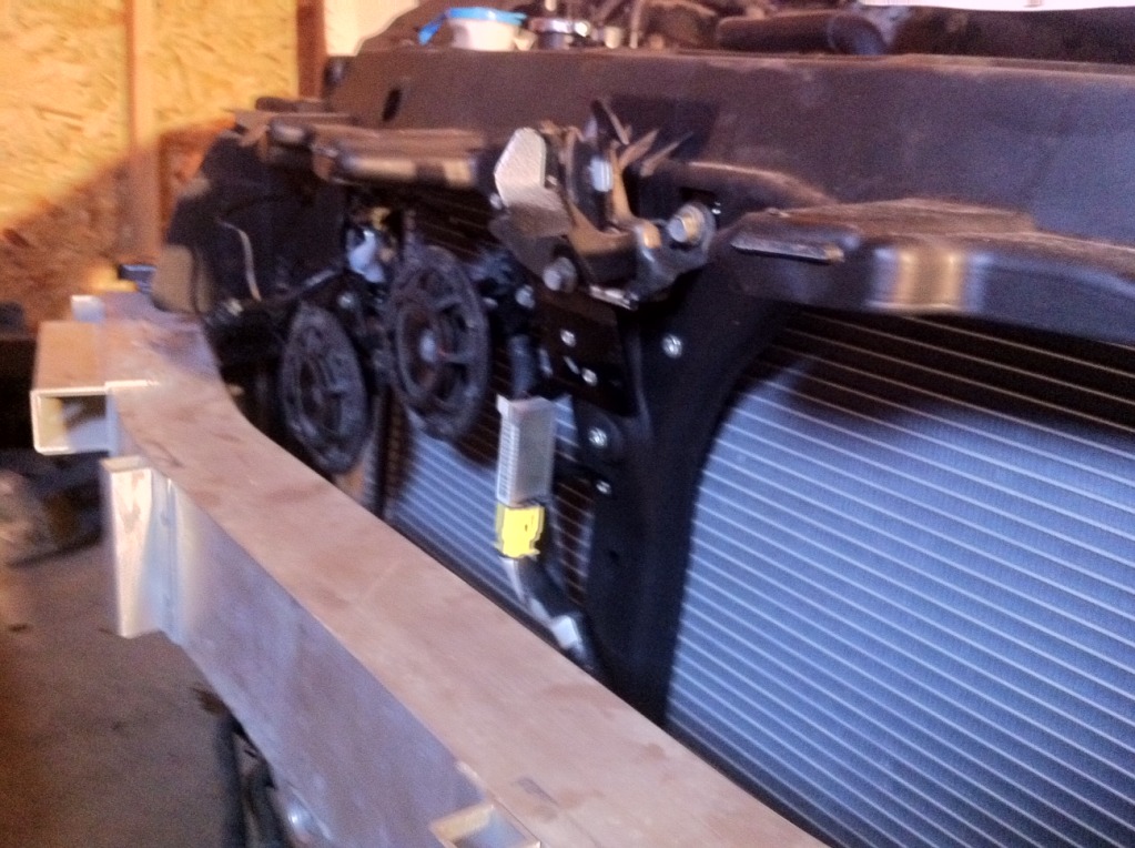

Here are some updates been busy this weekend
installed the major parts - radiator, condenser, rad support
Then all the little stuff
Then came the splash guards
Then the fenders ( which still needed to go to the body shop for some work and the lights
Now all im waiting for is the CAI to come in so I can start the car and install the hood and the speedy glass people to come and replace the wind shield and hopefully will be ready to pass the gov inspections oh yea and the bumper which im installing tomorrow

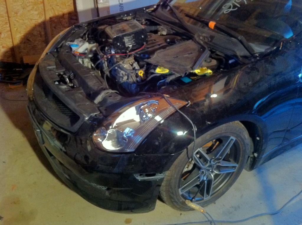

Yea added new power steering fluid, coolent, Engine oil... need the CAI to start the car so i can swap the transmission fluid and differential oil.
Anyways heres some updates still have to go to the body shop to repaint and fix the fenders but there on for now. gota really get a new grill lol I got this off the junk yard for 5 bucks

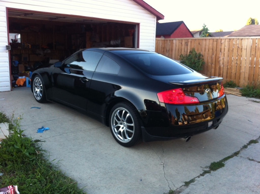

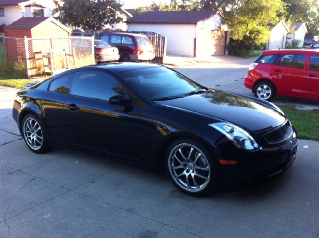

Smile Done!

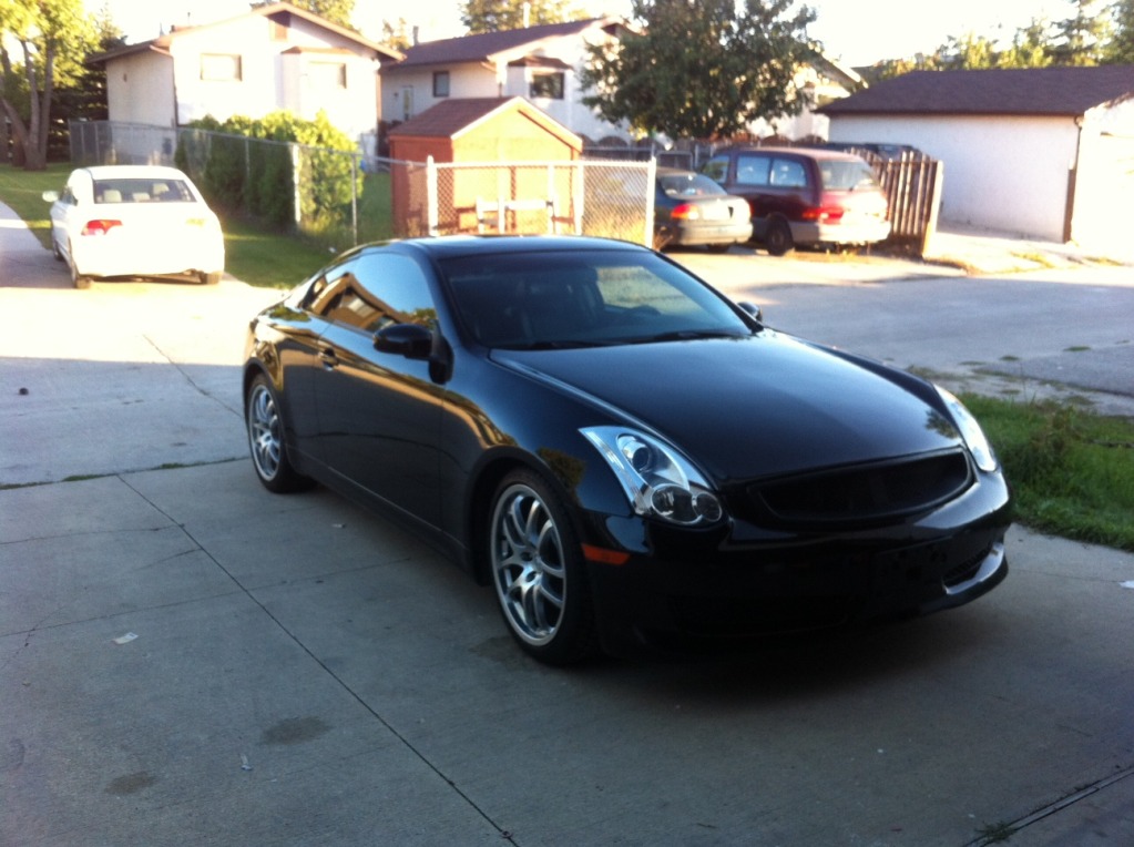

Its finally done! here are some pics.... this car sounds amazing
got my self some 19" OEMs from a guy in nicoclub forum
taking it to the dealer to get the AC recharged and the keys programmed and that will be it
