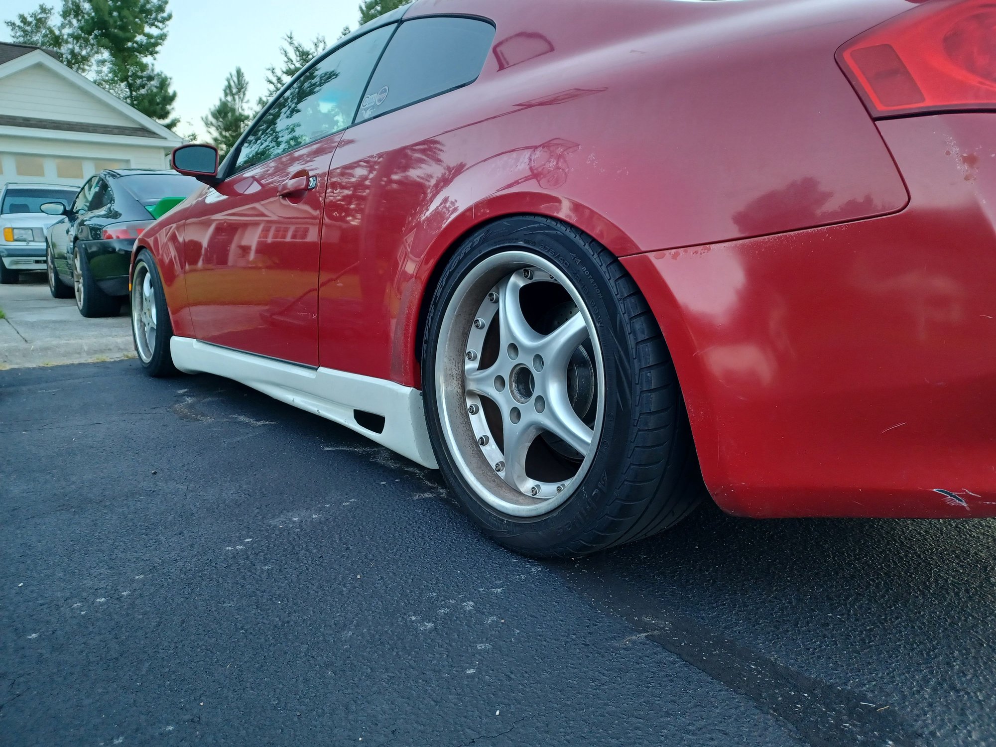

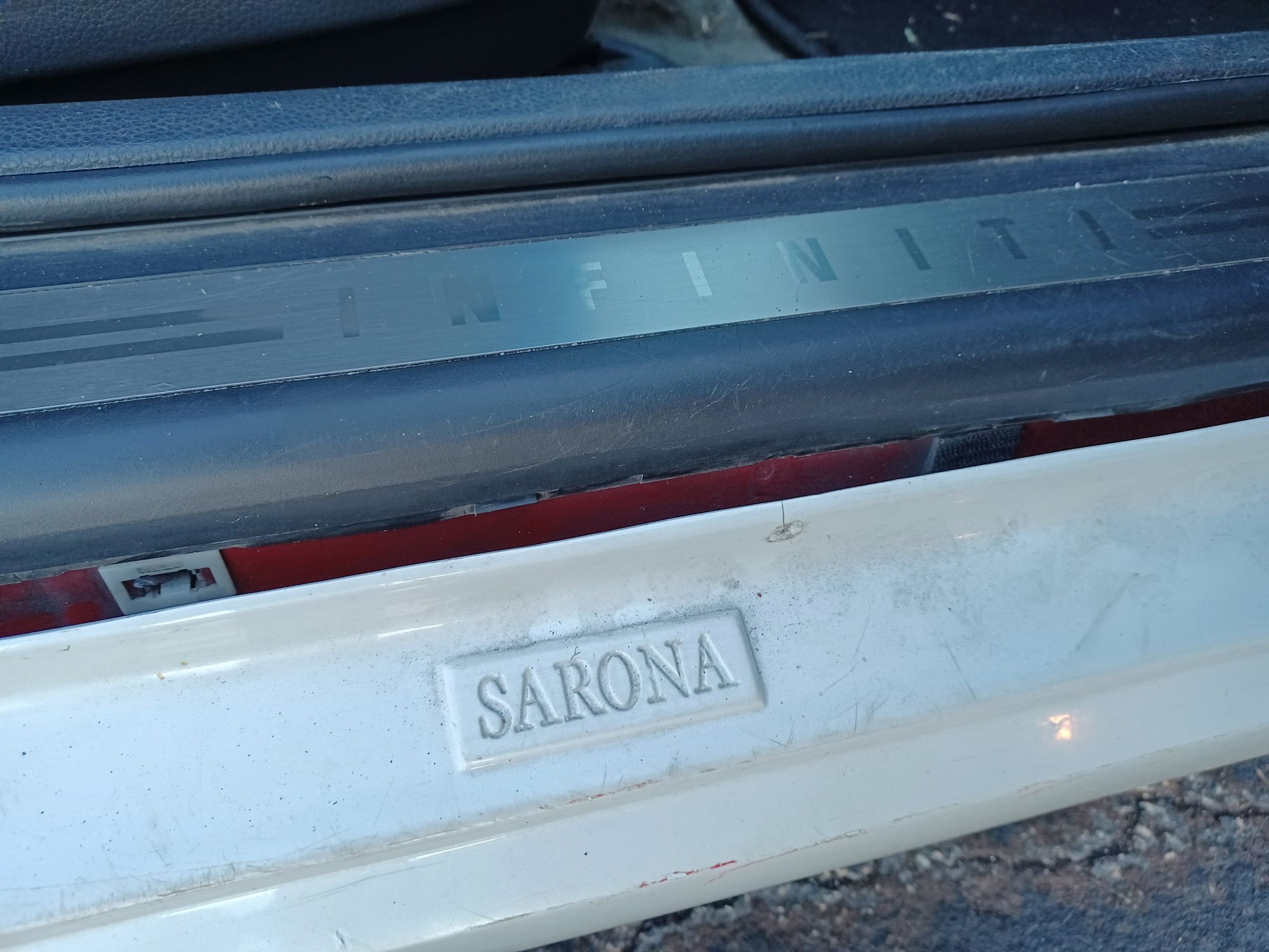

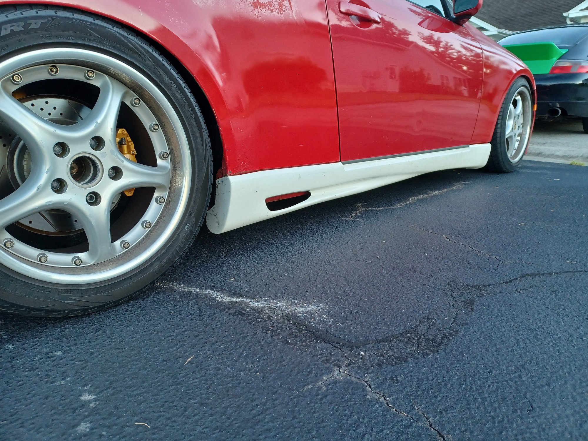

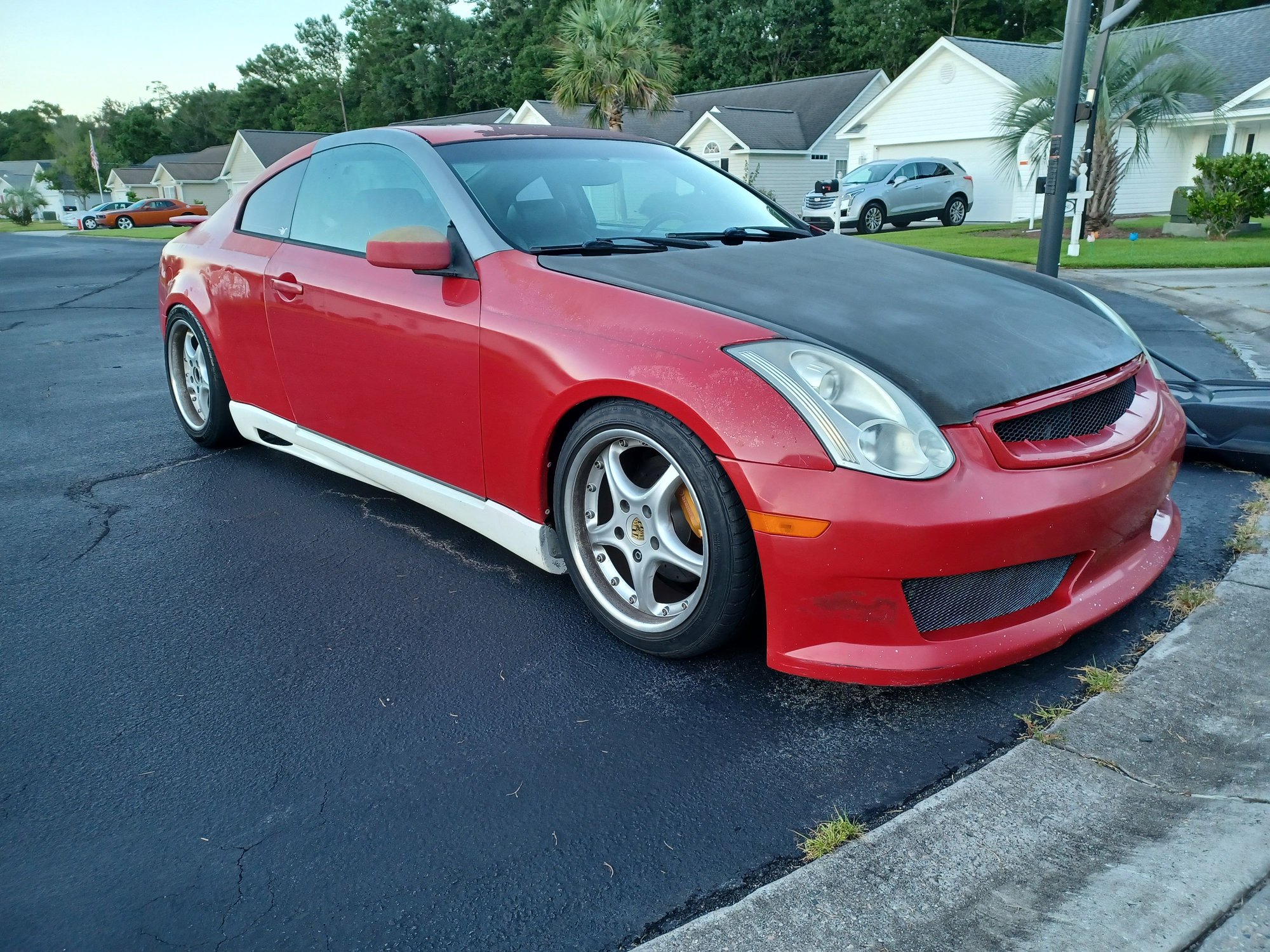

Spent the morning on an oil change and finally bracing the underside of this floppy duraflex Inven front bumper. I'll post some pics in a bit, but the Sarona skirts in the pics are not on the car anymore. Not my style. First $100 gets them for anyone interested. Pick up in Myrtle Beach, SC.

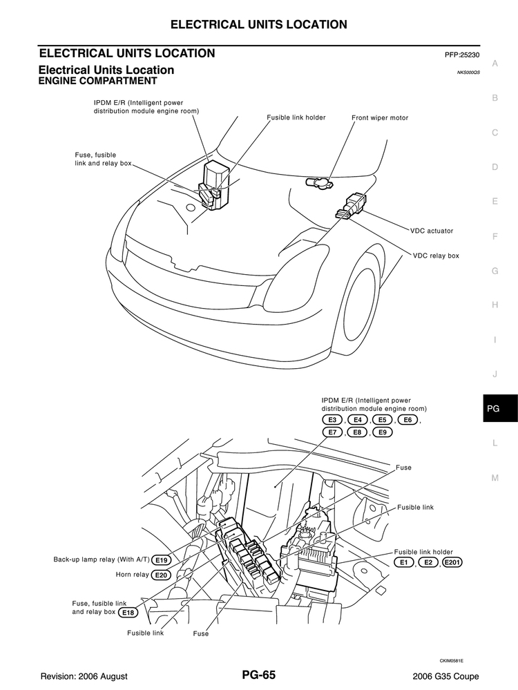

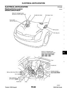

forgive me, but i've heard the term IPDM, but what and where is it? Is it the fuse/relay block behind the battery? same vicinity but other side of the firewall from the ecu?

Yes, that's it. It's nearly under the battery. Which is why if the battery tray drain holes get plugged with debris (not uncommon) and you have a windshield cowl leak or lack an undertray, you end up with not just a wet IPDM, but a deep sea IPDM. And leads to many questions about what on earth were the Nissan designers thinking....

The LOCATION of the IPDM is the problem, it should have sat in front of the battery not behind it.. Or there should have been a flange off the firewall to keep water from pouring on top of it during a deluge.

Yes it SHOULD, however it's not a submersible gasket, it's basically got a NEMA 5 dust tight location rating. If you remove the battery and the battery tray you can get to the VERY bottom where there's a small drain that gets clogged up over time. When it's clogged up and it's really dumping water you can actually FILL the battery box and submerge the IPDM. That would require a NEMA 6P box for complete submersion.
What's equally as common is for the cover to not be fully seated and the cowl drains being clogged just pouring water over the top of the IPDM.
