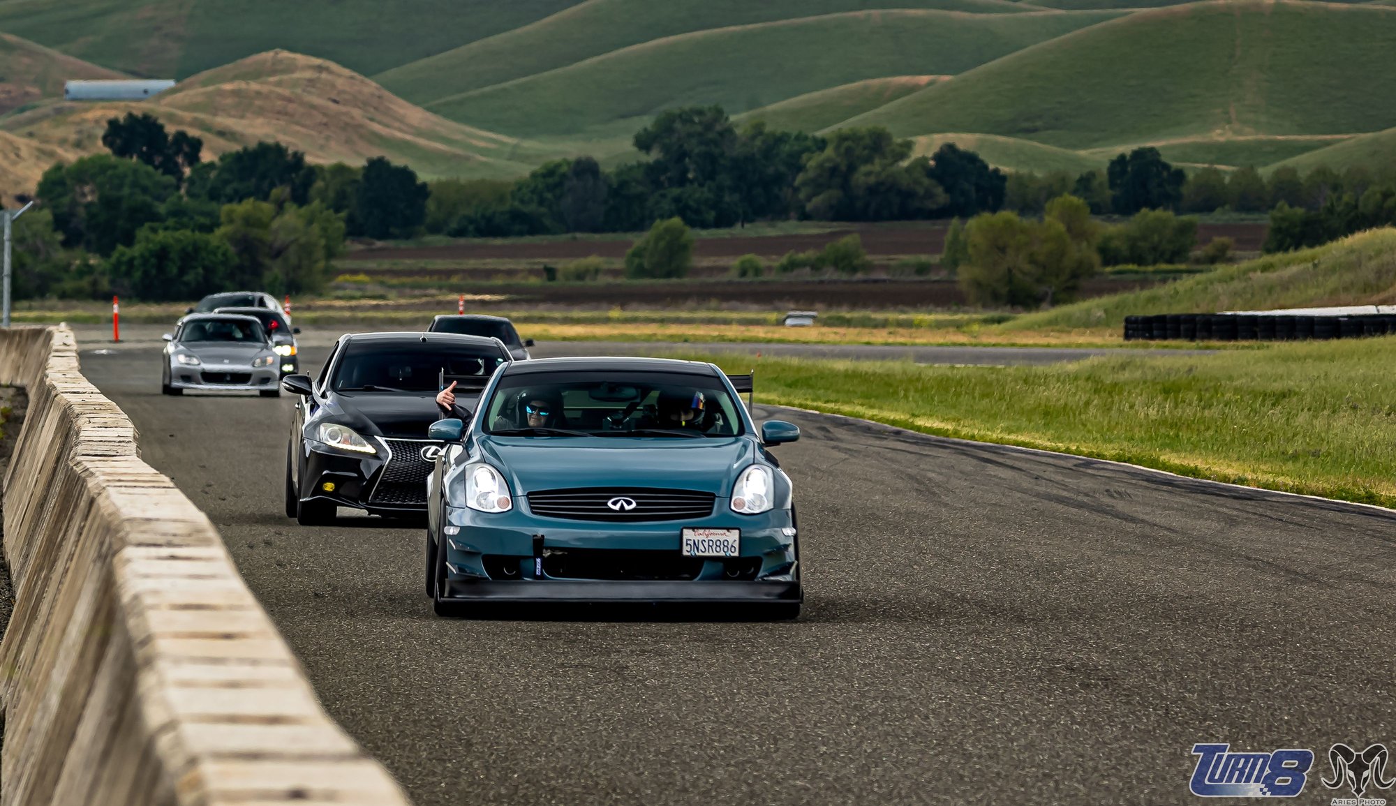

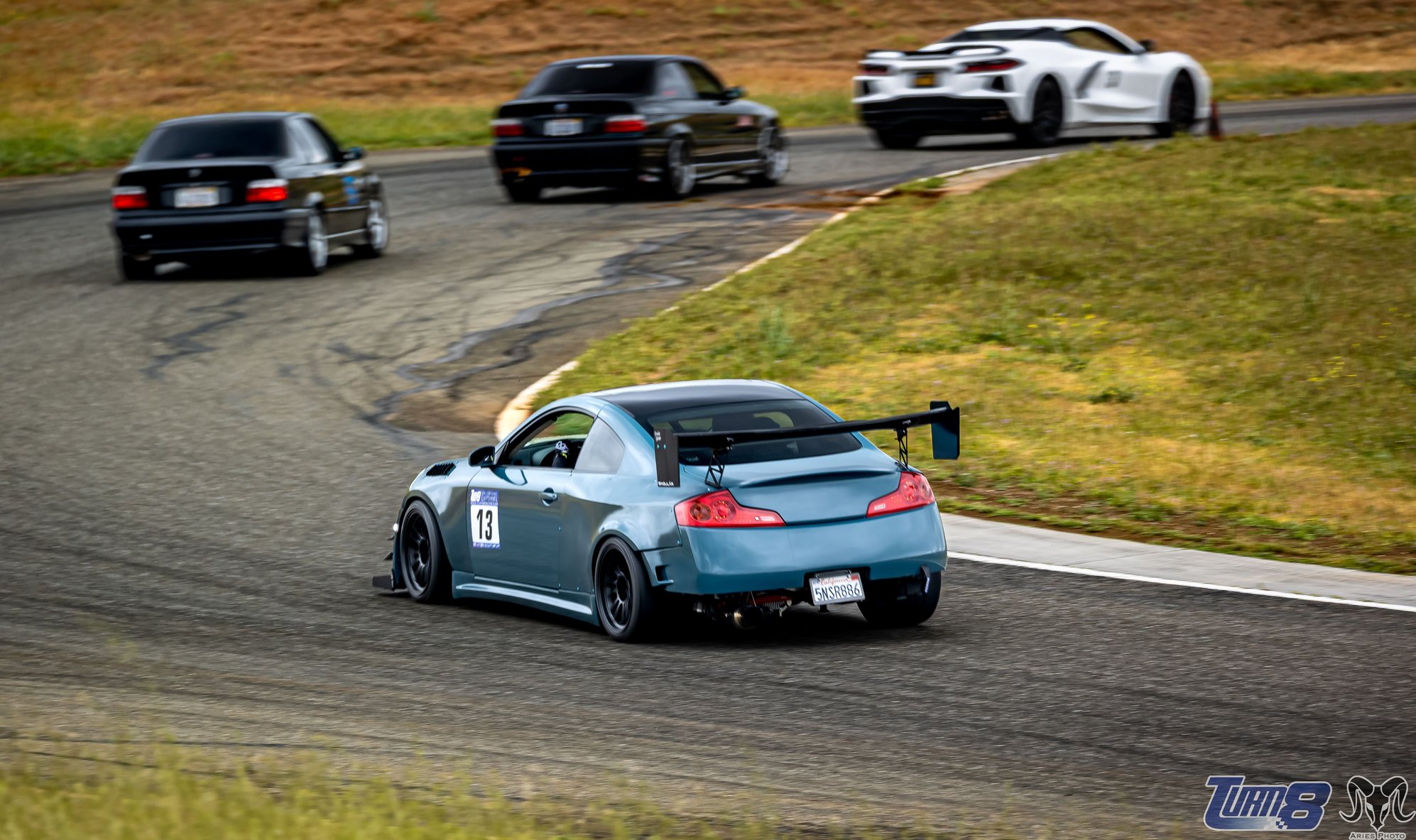

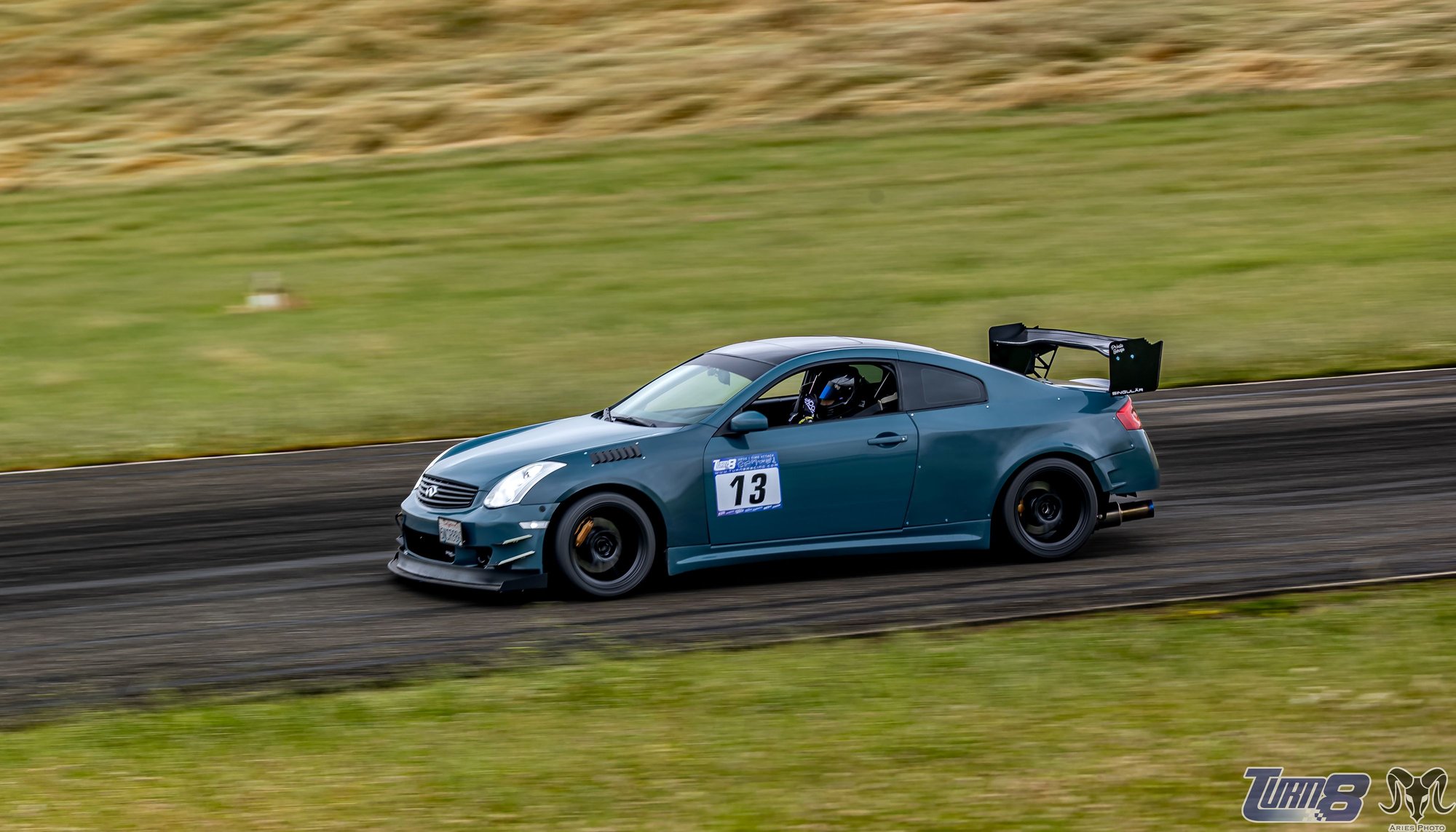

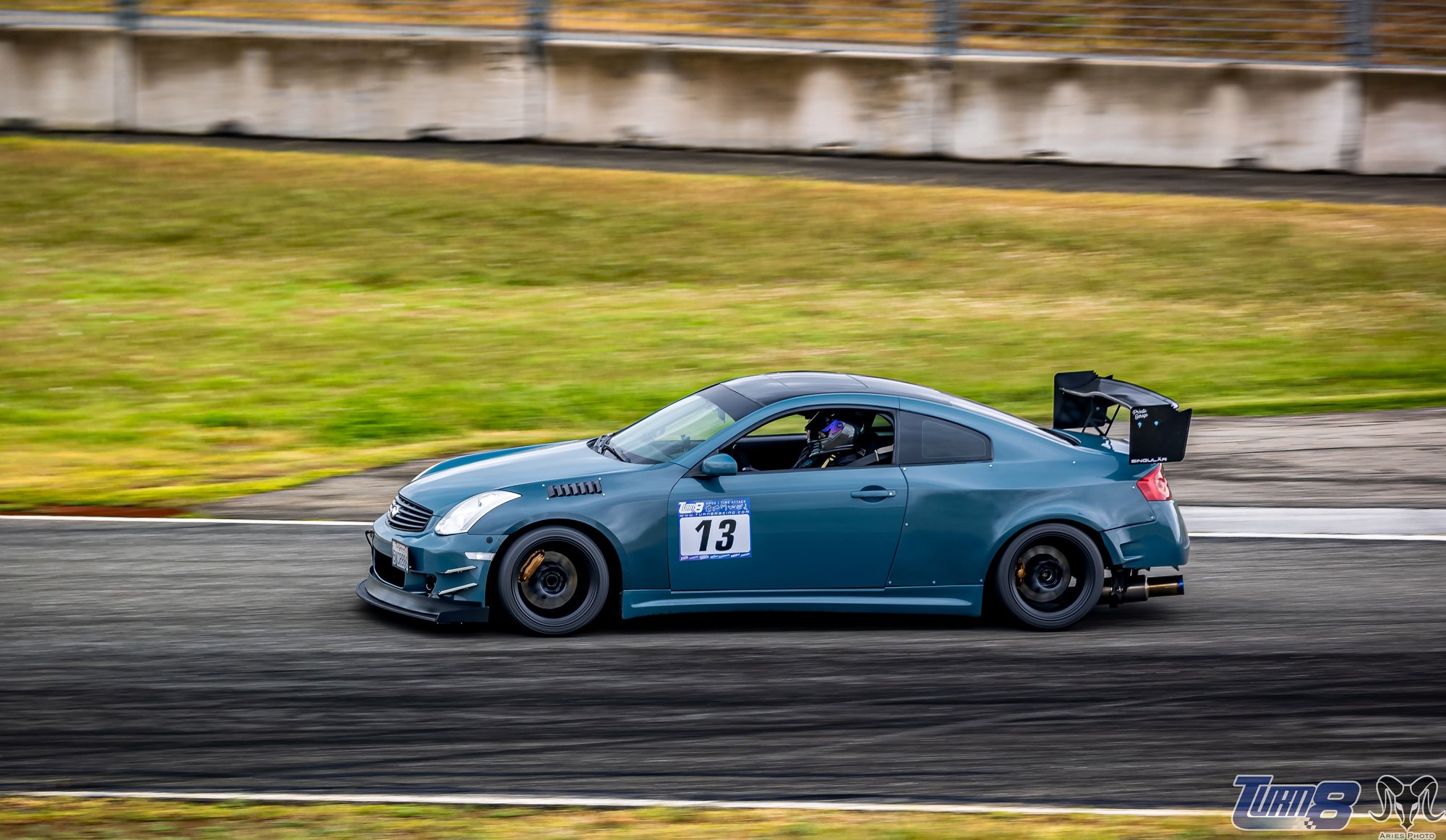

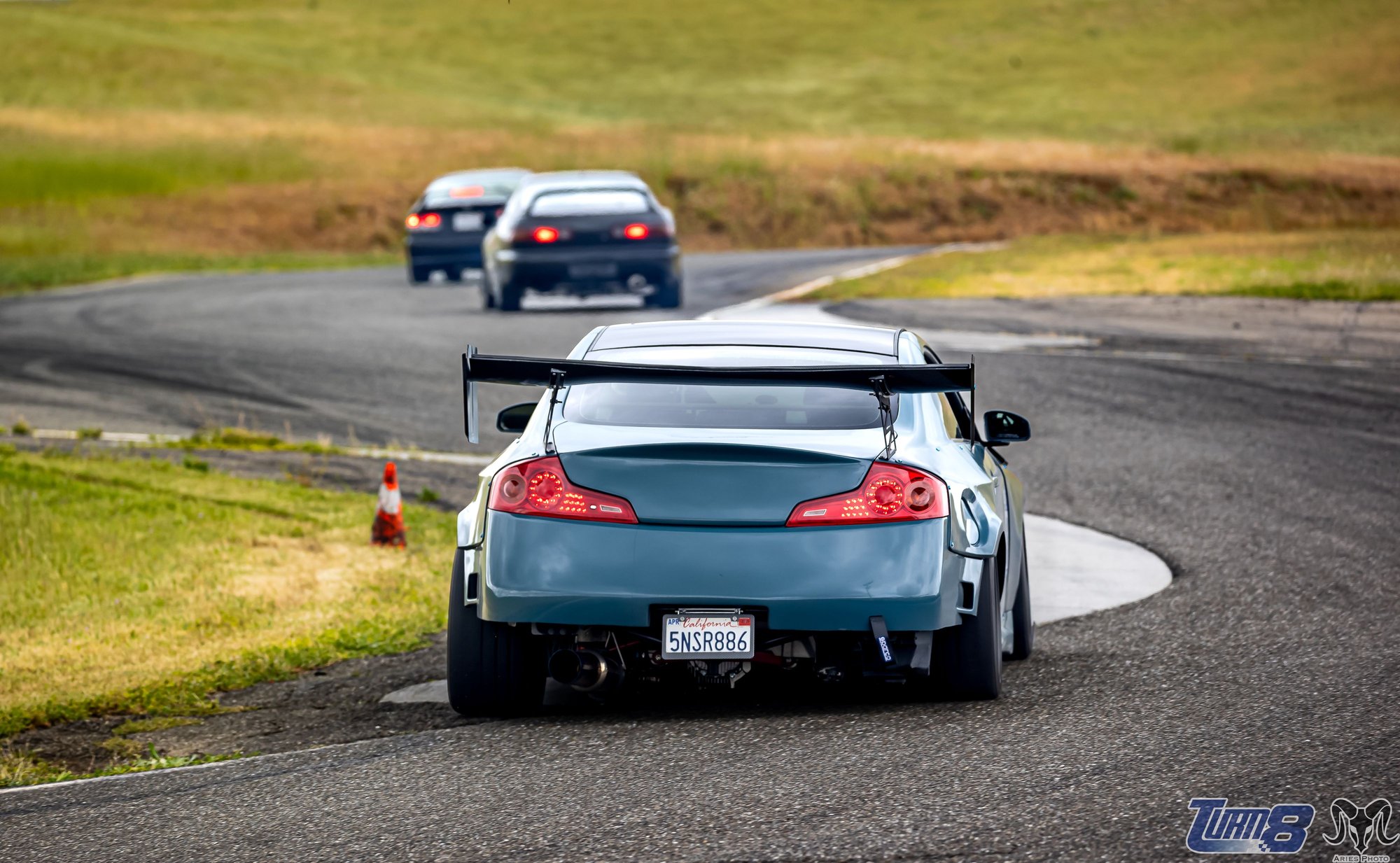

I do drive it on the street but just more of a weekend/track day car. The interior is gutted for the most part. The stereo, front dash, dash and headliner is still there. AC is also still installed.
How did you do the seem seal and how is it holding up? I'm interested in making the chassis more stiff as well. Was researching either welds or the seem seal.
For the engine just intake and a Stillen exhaust as CA is hard to keep everything CARB legal. I also did a DIY grounding mod (not sure if it actually does anything).
JWT lightweight flywheel and clutch with upgraded clutch line. Idle pulley delete.​​​​​
Solid motor mounts, transmission mount and rear diff mount.
Z1 rear diff brace
Z1 rear subframe bracket
Z1 brake master cylinder bracket
NRG front strut bar
Koyo radiator with their thermostat and Z1 hoses.Setrab oil cooler and power steering cooler from Z1. These kits are awesome btw. No issues installing and kept temps very consistent with no overheating.
BC BR coilovers with Swift springs 12k front 10k rear
SPL front lower control arm bushings
SPL upper control arms up front
SPL camber, traction and spring bucket arms in the rear
Stock Brembo calipers with Z1 2 piece rotors and upgraded lines. Hawk DTC 60 pads front and rear.
Sparco Pro 2000 bucket seats with sliders
OEM seatbelts right now but trying to figure out the best way to put in a roll bar/cage. Bolt in kits seem reasonably safe and economic.
Sparco steering wheel
Works bell hub
Currently have Cosmis 206R 18x11 295 35 18 nt05s in the rear and 18x9.5 with 285 35 18 up front.
I have some Konig 18x11 Hypergrams on the way. Looking to run a square setup all around.
Battleaero front splitter
Fiberglass Mafia rear overfenders
APR GTC 300 with with Singular motorsports endplates
I also just picked up a Garmin Catalyst. Looking forward to seeing how that works and seeing the data it records.

Thanks! With the Konig Hypergrams 18x11s You have to run a small 5mm spacers up front but other than that no issues. I have cut rear fenders and completely removed fender liners up front so keep that in mind.
