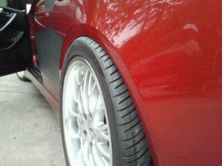

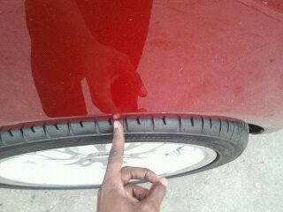

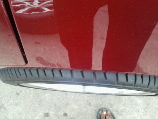

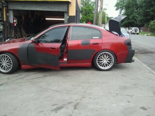

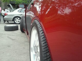

HELP!!!I have a problem fellas here it is.....
I bought a set of tsw
275/35/19 Rear Kumho Ecsta SPT (One has a hole.. needs to patched up or replaced)
245/35/19 Front General Exclaim UHP
OFFSETS: 19x8 and 19x9.5, +20 offset rear, +25 front
But it doesnt seem to fit my car. What can i do to fix this.... Pics is there
Attached Thumbnails OFFICIAL: Aggressive Wheel fitment FLUSH/STRETCH sedan-1307310406121.jpg   OFFICIAL: Aggressive Wheel fitment FLUSH/STRETCH sedan-1307309812812.jpg   OFFICIAL: Aggressive Wheel fitment FLUSH/STRETCH sedan-1307310392262.jpg   OFFICIAL: Aggressive Wheel fitment FLUSH/STRETCH sedan-1307310284874.jpg   OFFICIAL: Aggressive Wheel fitment FLUSH/STRETCH sedan-1307309701652.jpg
Old Jun 6, 2011 | 03:54 PM
  #3855
CandlestickPark's Avatar
ill Sedan
iTrader: (87)
Joined: Jun 2007
Posts: 23,261
Likes: 2,688
From: Long Beach, SoCal
Your tire size is too large out back and you need to add some negative camber. I ran a 9.5 +20 with a 255/35 and -2.75 degrees of camber.
