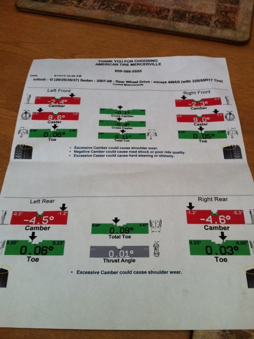

anyone here running the Stillen adjustable rear toe links? Im trying to piece together my suspension overhaul and was hoping these get my toe back in spec while being lower and more cambered.
My current alignment for toe is in spec with -4.5ish degrees rear camber, however i really want to get it back to -6.5 degrees rear camber, however the toe was wayyy out and couldnt bring it back in with just the toe bolts

Take it to a shop. They got my toe back to spec with only toe bolts and the camber is at -4.8 degrees.

my toe is in spec and aligned for now with just toe bolts. However i wanted more negative camber but at -6.7 degrees the toe couldnt be brought back in.

I have decided to eventually switch to Stance True style coils w/ upgraded spring rates then use a toe arm to replace the spring bucket and be able to straighten the toe out

Well then do it. Any toe arm should do the trick.

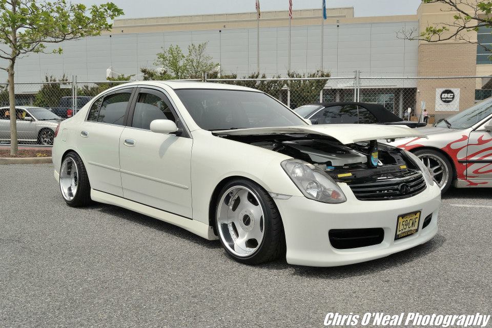

new setup... riverside aldstadts and bc racing coils, idk why the rears dont go lower? I got the true style coils with 12k/10k springs. Drivers side rear is slightly lower ~.25"
wheel specs - 18x9+11 front and 18x10.5+16 rear
tire specs - 215/40/18 front and 235/40/18 rear

They bottom out the struts, if you wanna get low on true coils you need Stance coils.
